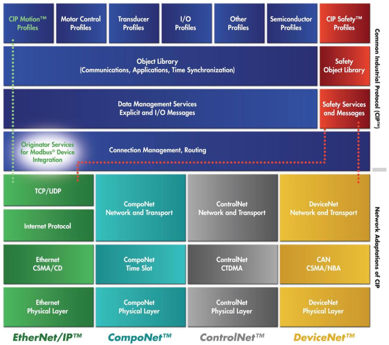

There are four industrial networks, sometimes referred to as “CIP networks” that incorporate CIP at the session, presentation, and application layers. EtherNet/IP implements CIP over standard Ethernet. Similarly, CIP applied over a CAN network forms the basis for DeviceNet. ControlNet uses CIP over a CTDMA (concurrent time division multiple access) data link layer, and CompoNet implements CIP on a TDMA (time division multiple access) data link layer.
In addition to the family of networks above, CIP also includes extensions that enhance its functionality: CIP Safety for fail-safe communication in functional safety implementations; CIP Sync for real-time synchronization between devices; CIP Motion for multi-axis, distributed motion with deterministic, real-time control; and CIP Energy for monitoring and managing energy consumption to ensure optimization of energy usage (OEU).
common industrial protocol
From the bottom, the OSI layers are: physical, data link, network, transport, session, presentation, and application. (This diagram includes an additional layer at the top, referred to as the “user” layer, where device profiles are stored.) Although the physical, data link, network, and transport layers differ, the family of CIP networks all implement CIP at the top layers.
