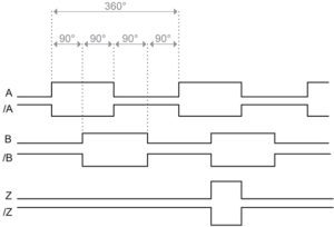

This is a signal diagram for a TTL output encoder showing complementary (differential) signals. TTL output is often called differential line driver output.
Rotary encoders can also track linear distance traveled, based on how many rotations of the shaft have taken place; or speed, based on the change in shaft position relative to the measurement time.
Incremental encoders output two square-wave signals — A and B — in quadrature, meaning they are phase-shifted by 90 degrees relative to each other.
TTL output uses differential wiring (A with /A and B with /B) to cancel noise.
Most incremental encoders also include an index signal, which is typically denoted Z. The Z signal is a single pulse that occurs once during each shaft rotation and can be used to indicate a zero position.

With two output signals, A and B, the receiver or controller can determine whether the shaft is rotating in a clockwise or counterclockwise direction, based on which signal is leading, or rising.
Quadrature output refers to the waveform of the signal, but there are also different types of output circuits, with the most common types being open collector, HTL, and TTL.
TTL output circuits provide not only the A, B, and Z signals, but also their complementary, or differential, signals, denoted /A, /B, and /Z.

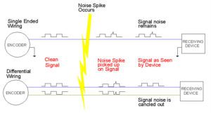

When long cable lengths are used, stray electromagnetic fields or currents induce unwanted voltages, which cause noise.
Image credit: Quantum Devices Inc.
TTL output reduces or eliminates this noise through its use of differential signals.
In a differential pair of signals (wires), the unwanted voltages are the same in each wire.
Because the TTL output signals are complementary (opposites), the controller can sum the voltage of each signal to remove the noise and retain the original voltage.
