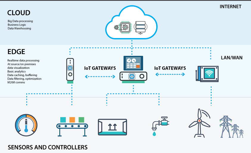

A term often used when discussing the IoT or IIoT is “edge devices” — referring to IoT-enabled sensors, actuators, and other devices. The term “edge” typically refers to the boundary between the physical world (devices) and the cloud (or higher-level system).
Similarly, IoT gateways that can perform advanced functions — such as filtering, manipulating, and processing data — are sometimes referred to as “edge gateways” or “intelligent gateways.” When data analysis is moved from the cloud or remote network to the edge — often to the gateway or to the device itself — this is referred to as “edge computing.”
IoT gateway
Moving some processing functions from the cloud to the edge – to the devices themselves and to the IoT gateway – helps ensure that critical data is timely, accurate, and reliable. It also reduces the bandwidth and computing resources required for IIoT applications.
Image credit: Open Automation Software
The benefits of using an edge gateway, particularly in IIoT applications, is that moving data processing functions from the cloud to the edge helps ensure accuracy and reliability. Transmitting data to and from the cloud takes time, and even milliseconds are too long for many mission-critical decisions and processes that occur in industrial operations. In the time it takes to send data to and get a response from the cloud, the data could easily become obsolete, resulting in missed opportunities for action, damaged components or products, or risks to the safety of the equipment or personnel. Edge devices can also send data or commands directly to other devices for immediate action.
Edge computing, via an edge gateway, also makes it possible to keep sensitive data “on-site” to ensure its security. And there’s the issue of practicality. Some devices or systems generate so much data that the bandwidth and resources needed for the cloud to handle this data are too costly. The edge gateway can determine what data gets sent to the cloud and transmit it in the most efficient, usable form.
