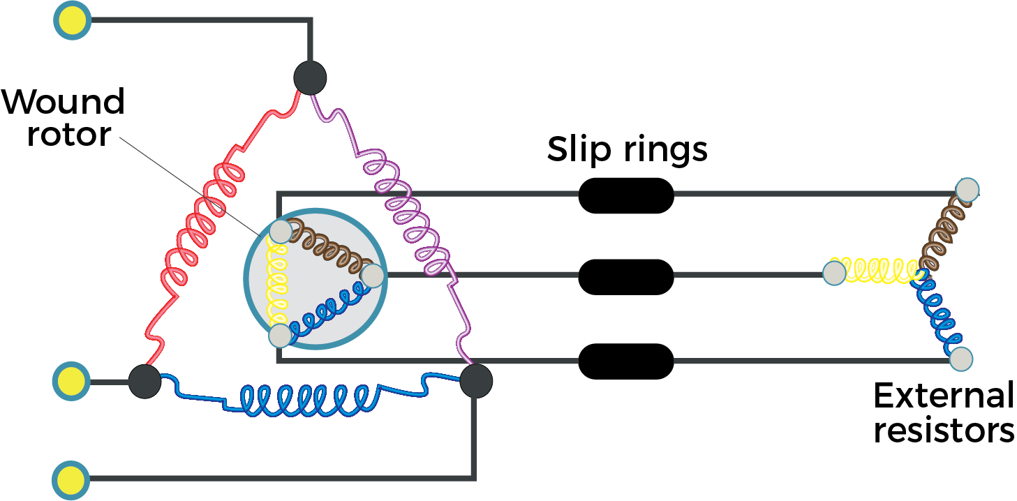

Slip rings find use in the startup of asynchronous electric motors — in the ac induction motors known as wound-rotor motors. Here, they don’t transfer power. Rather, they insert resistance into rotor windings.To be clear — a slip ring in a motor is not the same as a commutator. Yes, their designs and functions are similar. But a ring in a slip ring is continuous. In contrast, commutators are segmented. Read more on this topic at the post: What is a wound rotor motor?
In short, slip rings in wound-rotor motors have three circuits. The rings are on the motor shaft (isolated) and made of copper or an alloy.
Photos: WEG Electric Corp.
Each connect to one of three rotor-winding phases. Graphite brushes connect to a rheostat or other resistive device. When the slip ring turns with the rotor, the brushes ride those rings and impart resistance to the rotor windings. That brings rotor current more in-phase with stator current. This boosts torque output with relatively low current. After the motor start-up sequence ends (and the motor reaches full speed) the slip rings short out and lose contact (to avoid dings to efficiency and torque they’d otherwise impart) and let that motor run as a standard ac induction motor.
