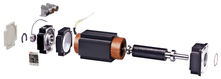

This exploded view of a brushless servo motor shows how the internal components of the motor fits together.
