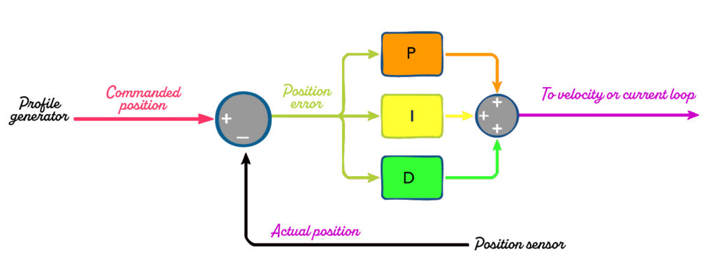

In the PID position loop diagram the ‘loop’ part of the controller is the summing junction at which actual position is subtracted from commanded position to generate a position-error value. The PID part of the controller is actually a type of filter known (not surprisingly) as a PID filter. The PID filter takes as input a stream of position error values and generates as output a stream of commands to a current loop, or for some systems a velocity loop.
This is a general-purpose servomotor-positioning control diagram.

Shown here is a simplified PID position loop.

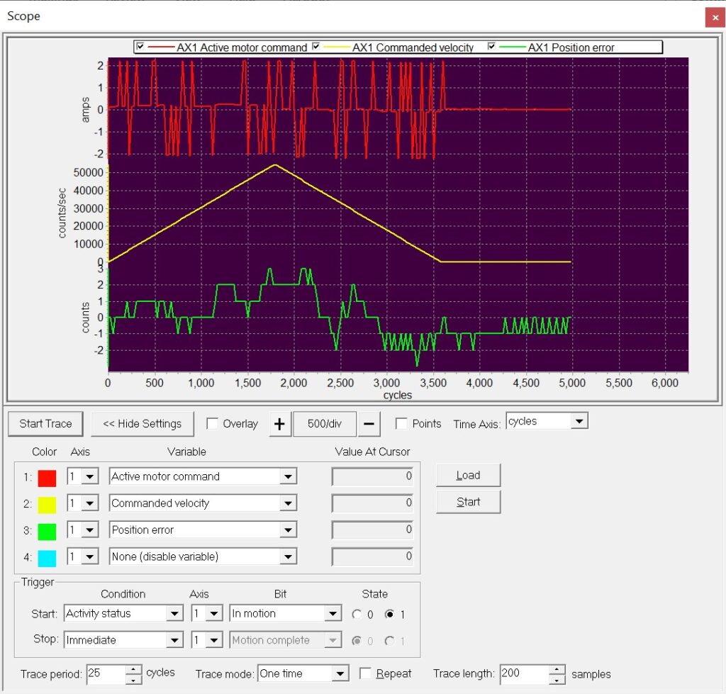

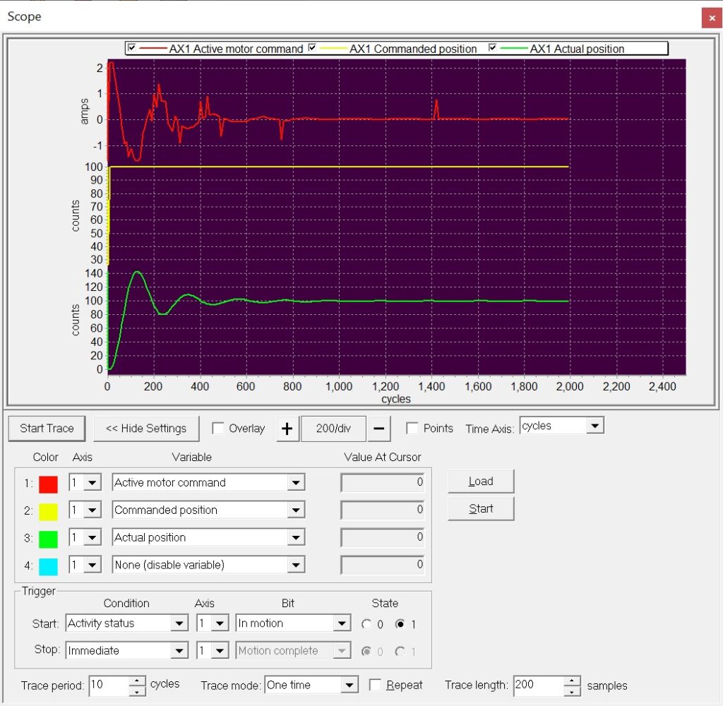

To make step response tuning work, or for that matter any manual tuning method, we need a position trace facility to display the results of the moves. At a minimum we need to display a stream of captured values of the target position (commanded by the trajectory generator) and the actual position (as the motor’s measured location).
Consider the screencapture of such a facility — motion scope and trace software from one motion supplier. In fact, design engineers can use this software, similar products from other motion-control vendors, or even systems developed in-house.
This is an example of a system capture made with PMD’s Pro-Motion software.

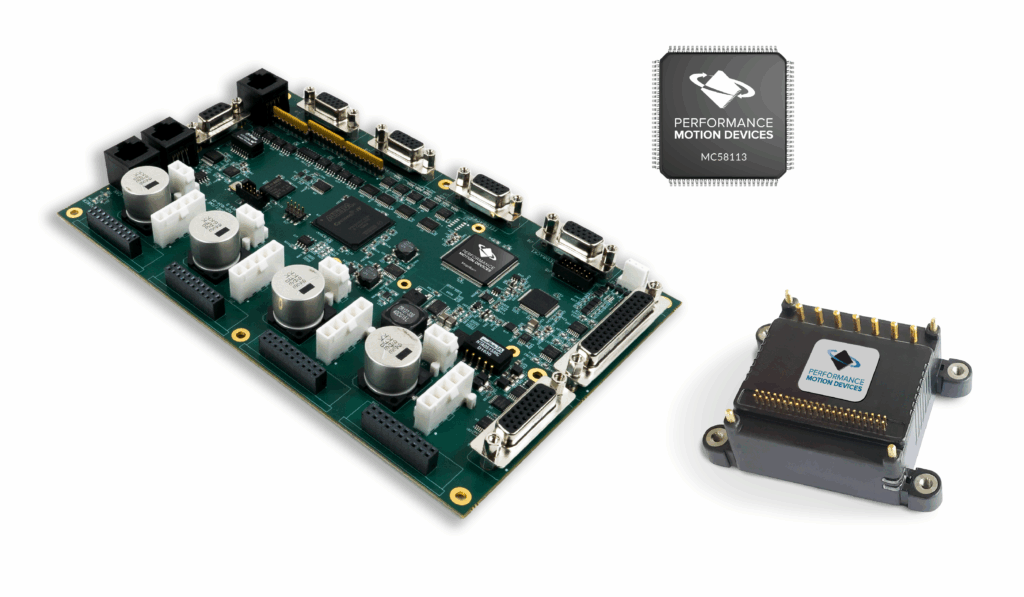

Performance Motion Devices’ Prodigy/CME machine controller boards provide high-performance motion control for medical, scientific, automation, industrial, and robotic applications. Available in one, two, three, and four-axis configurations, these boards support dc brush, brushless dc, and stepper motors … plus accept and run user-written C code. Atlas amplifiers onboard the Prodigy/CME eliminate the need for external amplifiers.

  • View the scope display to determine whether the response is underdamped, critically damped, or overdamped (as described below).
  • Adjust the gain settings accordingly.
  • Make another step move (as in Step 4).
The next three sections will show one how to characterize the step move response and how gain settings should be adjusted.

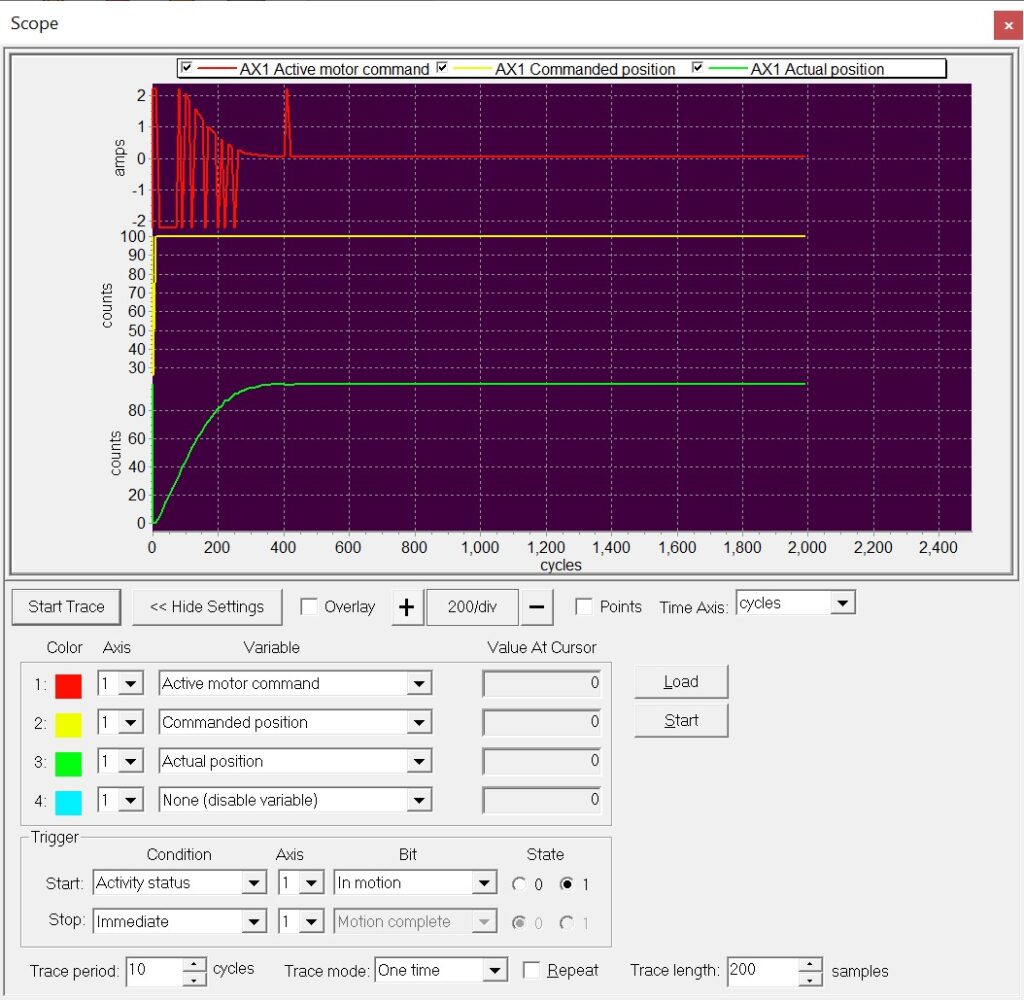

Underdamped servo response curve: Refer to the screencapture showing a typical underdamped response. The yellow trace shows that the commanded position instantly changes from a position of 0 to 100. With the software being used in this situation, this jump equals whatever the engineer entered into the step-response dialog box. The green trace shows the resultant motor location.
Though actual position does eventually settle to the commanded 100, it overshoots and oscillates several times. A system behaving this way is underdamped. To correct it, the design engineer should increase the derivative gain Kd.
Pro-Motion software is PMD’s Windows-based exerciser and motion-analysis program. Capabilities including a step-by- step motor setup axis wizard, auto-tuning, configuration storage, and sophisticated motion data trace and display. Advanced users can access a complete motion-analysis package with Bode plot generation. This is a screencapture showing a typical underdamped response. The yellow trace shows that the commanded position instantly changes from 0 to 100. Here, this jump will equal whatever one entered into the step response dialog box. The green trace shows the actual motor location that results.

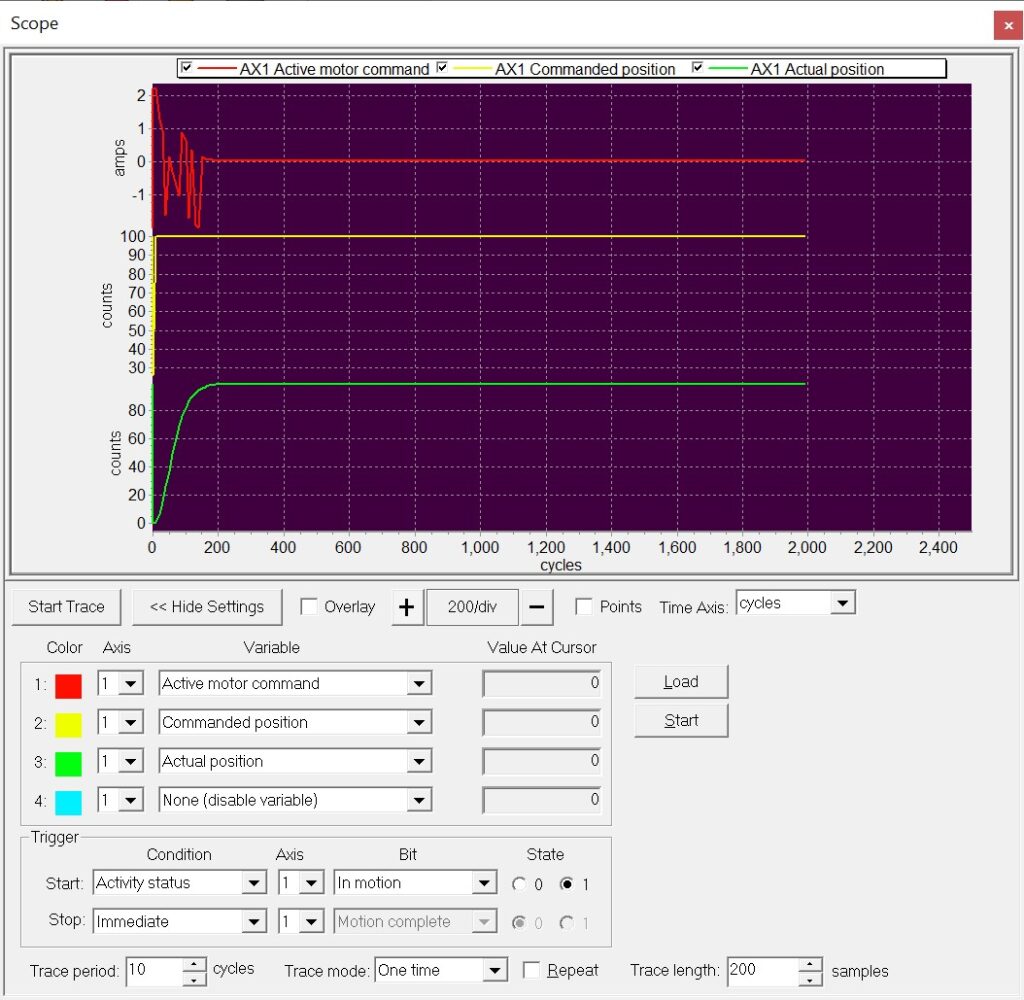

Critically damped servo response curve: Now consider the screencapture of a plot of a critically damped response. In this trace the actual position doesn’t overshoot the commanded position, and it settles quickly (in 10 msec) to the commanded position of 100. Note that in these given trace displays, the unit of time is set to servo cycles. For the controller used in this setup, that’s 50 µsec per servo cycle.
It’s worth noting that many Kp and Kd combinations may spur a response that appears critically damped. In this manual tuning process, the distinction between critically damped and overdamped is somewhat subjective.
This is an example screen from PMD’s Pro-Motion Windows-based motion scope and trace software — more specifically, the plotted response of a critically damped system. This sample capture and display software can help design engineers in their servotuning work.
