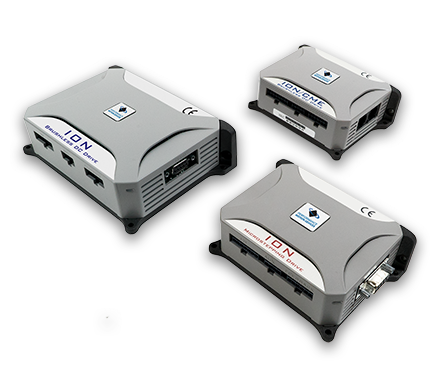

ION 500 and 3000 drives are intelligent drives in a cable-connected package. Advanced servomotor control is complemented with S-curve point-to-point moves, i2T power management, downloadable user code, and a range of safety functions including over current, over voltage, and over temperature detect. IONs are easy to use components that quickly get applications operational.

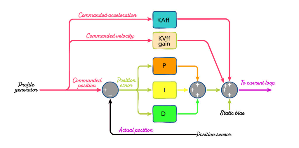

Acceleration and velocity feedforward
Feedforward techniques improve real-world servo-controller performance — especially if positioning accuracy during the move is important (as in machine tools, 3D printing, and tracking applications). Feedforward has no effect on system stability and so is a kind of free pass for boosting axis performance.
This is a position PID loop with feedforward.
