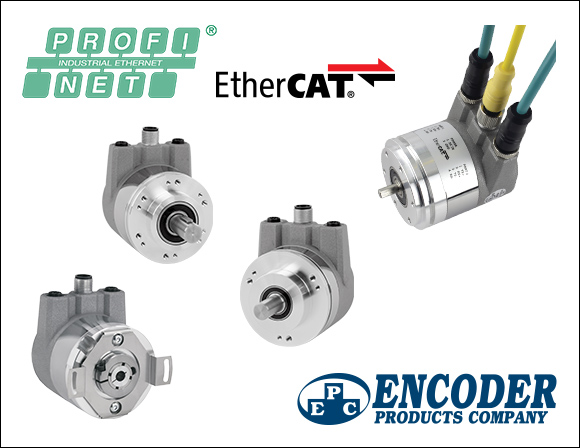

The Model A58HE and Model A58SE Ethernet-ready, multi-turn absolute encoders from Encoder Products Company (EPC) are designed for harsh factory and plant environments. In addition to EtherCAT Deterministic Communication, the two models now feature the PROFINET communication protocol as well. encoders
These encoders are particularly suited to applications where fieldbus connectivity is required, and the encoder has to retain absolute position information after power-off events. The Model A58HE is a 58-mm encoder in a blind hollow bore construction, and the Model A58SE is a 58-mm shaft encoder available with either a clamping flange or synchro flange, in both compact and heavy-duty configurations.
“Both the A58HE and A58SE encoders are easily designed into a wide variety of applications,” says Sarah Walter, electrical engineer and EPC Technical Applications Manager. “And with the new heavy-duty model and the new compact model – which is the most compact unit available on the market – they are incredibly versatile mechanically. What really sets our encoders apart, however, is the high accuracy. These absolutes will give you accurate motion feedback, every time.”
The Model A58HE and Model A58SE absolute encoders offer:
  • EtherCAT Deterministic Communication or PROFINET Communication
  • Multi-turn resolution up to 43 bits
  • Single turn resolution up to 16 bits
  • 58 mm diameter housing
  • Bores sizes up to 0.375 in. or 15 mm
  • Shaft diameters up to 0.375 in. or 12 mm
  • Durable magnetic technology
  • Proven turns counting technology with no gears or batteries
  • Operating temperature range of -40 °C to 85 °C
  • Sealing rating of IP65
  • Continuous digital position monitoring
  • Ability to retain absolute position after a power outage
  • Meet CE/EMC Standards for Immunity and Emissions
The PROFINET option on the Model A58SE and Model A58HE will be available October 1.
