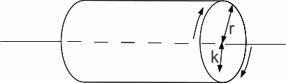

In motion control applications, inertia is generally given as J (as shown in the equation above) and is defined as “mass times radius squared.” However, in many rotating equipment applications, inertia is given as either WR2 or WK2 and is defined as “weight times radius squared.”
Notice that the inertia equations for induction motors use weight (which is a force) rather than mass. Also notice that the distance (radius) can be specified as either “R” (WR2) or “K” (WK2). R is the radius of the object, from its center to its outer edge. K is the radius of gyration, which is the distance from the point around which the object rotates, to the point at which the mass can be considered to be concentrated.
These expressions for inertia — WR2 and WK2 — are often used interchangeably, although R (radius) and K (radius of gyration) are rarely the same values. Here’s why…

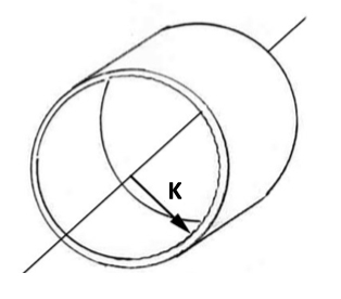

If a hollow cylinder with extremely thin walls rotates around its axis, it’s reasonable to assume that the cylinder’s mass (weight) is concentrated around the outside circumference. So the radius of gyration for the thin-walled cylinder will be measured from the center to the outside edge of the cylinder. Thus the radius of gyration, K, is equal to the radius of the cylinder, R.
induction motor inertia
If a hollow cylinder has very thin walls, the mass can be assumed to be concentrated at the outer circumference of the cylinder.
