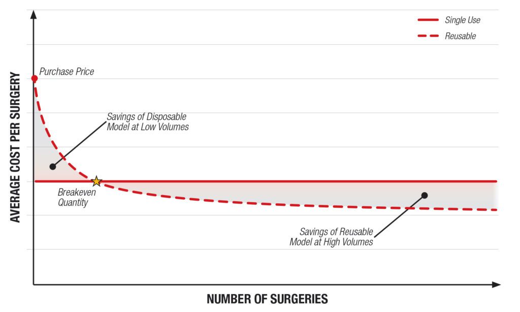

Refer to the charts accompanying this article for average-cost analyses of various tool options. These don’t account for how high-end reusable tools typically offer superior performance and additional capabilities. Such factors may make tools based on BLDC motors the best design choice for surgeons and patients even if a breakeven surgery quantity isn’t reached. However, the analyses also don’t account for one unpredictable cost of the sterilization process — the potential risk of infection from inadequately sterilized reusable tools. Well-enforced sterilization methods and tool design features can certainly facilitate proper and reliable sterilization, and sterilization has been proven safe and effective. However, inadequate tool sterilization between surgeries is a risk that should also be considered by surgical-tool design engineers. Disposable tools can be sterilized and packaged by the tool OEM, and this approach boosts patient safety for some applications and hospital systems.
With disposable tools, cost incurred for a single surgery includes the full purchase price of the tool. With reusable surgical tools, a small portion of the purchase price is amortized for each procedure … although the cost of re-sterilizing these power tools incurs additional cost that should be considered in per-surgery cost assessments.

The BLDC motor can easily meet the speed and torque requirements and could continue to do so for many surgeries. Efficiency doesn’t quite meet the 80% target, and the price is much higher than $20 … so for the BLDC motor to be viable, it’d require use in at least eight surgeries.

A costlier reusable tool (perhaps using a higher performing BLDC motor instead of a low-cost brush DC) will necessitate uses in more surgeries to be less expensive than a disposable tool. Sterilization costs also increase the number of procedures needed to break even — so much so that disposable tools are in some cases preferable no matter the number of surgeries.
