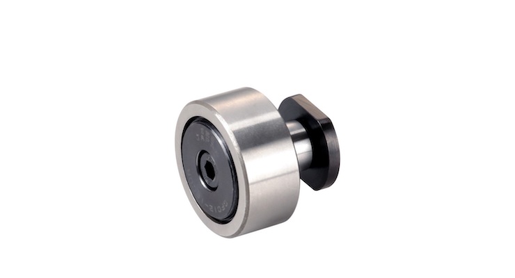

IKO International has introduced its CFC…B Series of short stud-type cam followers. These new cam followers have a unique mounting structure that solves space limitations that often exist on the stud side of the assembly region, thereby satisfying mounting requirements without sacrificing performance.
cam follower
The CFC…B cam follower’s mounting structure consists of a hexagon socket head bolt and a dedicated flange nut that not only creates a more compact cam follower, it reduces the required mounting space on the stud side by up to 34 percent — far more than conventional cam followers. By providing greater design freedom, this cam follower family can enhance production efficiency for a wide range of applications across many industries such as robots, electronic devices, manufacturing and automated equipment.
