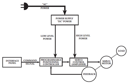

A servo system is one in which the system’s error (in position, speed, or torque) is corrected through the use of a feedback device that compares the system’s actual performance with its commanded performance. What makes a motor a servo motor, then, has less to do with its construction and operation, and more to do with whether it incorporates or reads feedback in a closed-loop system.
servo motors
A servo motor is one component in a complete servo system.
Image credit: Baldor Electric Company

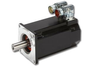

servo motors
A typical brushless AC synchronous servo motor, with connectors for power and feedback.
Image credit: Kollmorgen
Brushless AC (BLAC, aka PMSM or PMAC) and brushless DC (BLDC) motors are synchronous, and both types are frequently used as servo motors. In fact, some of the most common high-performance industrial servo motors are 3-phase, synchronous, brushless AC motors.
