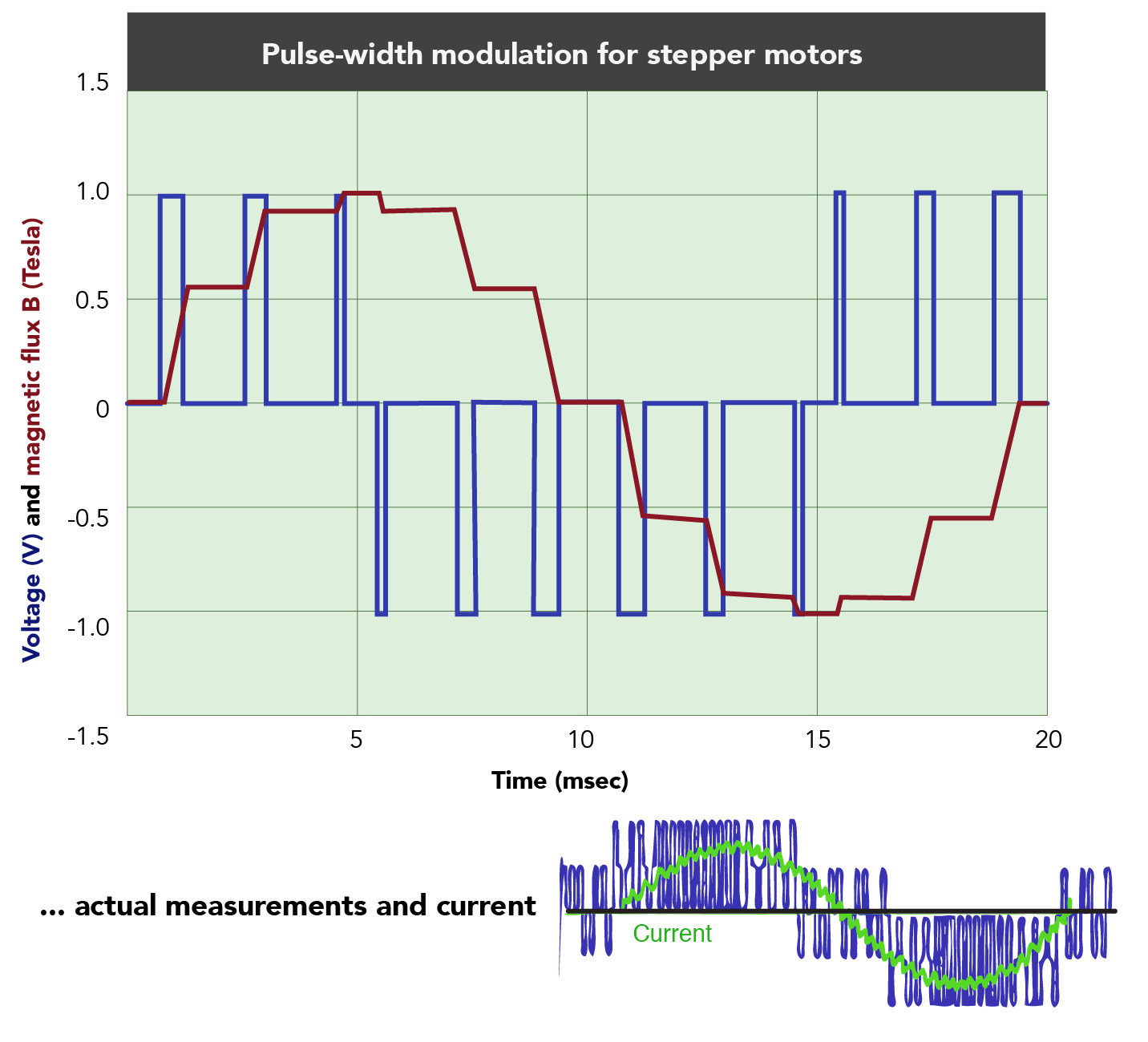

Pulse-width modulation or chopping is another option. Here as current increases, the controller holds supply input to 100% duty cycle.
Click to enlarge.
At target current, duty cycle drops to whatever is necessary to maintain operation. While effective, this method’s drawback is torque ripple. This can cause high-pitched noise in smaller motors. In larger motors, this can create ac voltages on nearby lines. To reduce ripple, designs will often increase the chopper frequency … but this can only go so far before losses are excessively high.

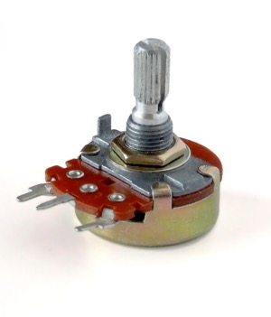

A potentiometer is one component for current limiting. Courtesy Iainf of Wikimedia Commons.
Another method to holding current is to use a potentiometer. These are easily adjustable and work well enough for small to medium applications. But because they dissipate power directly, they have some of the same drawbacks as linear limiters and resistors — including the generation of heat and the fact the dissipated power may quickly match whatever it takes to power the load.
