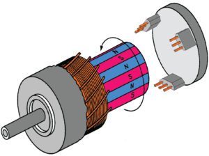

Hall effect sensors
A brushless DC motor with three Hall effect sensors to detect rotor position.
Image credit: Honeywell International, Inc.
The basic components of a BLDC motor are a rotor with permanent magnets and a stator with windings. Torque is produced by the repulsive forces between the magnetic fields of the stator and the rotor. An important distinction between BLDC motors and their counterparts, permanent magnet AC (PMAC) motors, is that the windings in a BLDC motor are trapezoidally wound, which produces a trapezoidal back EMF waveform. Because their back EMF is trapezoidal, BLDC motors typically use trapezoidal commutation, whereas PMAC motors are sinusoidally wound and use sinusoidal commutation.
In trapezoidal commutation, the rotor is monitored by three Hall sensors, which provide rotor position information every 60 degrees (rather than continuously, as with sinusoidal commutation). This produces six torque ripples per electrical cycle of the motor, or 12 torque ripples for every full mechanical revolution of the motor shaft.
