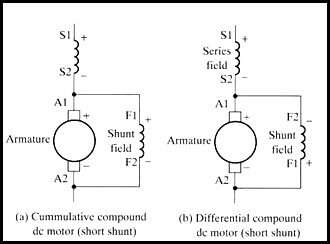

Compound wound
As the name suggests, a compound wound DC motor is a combination of series and shunt wound designs, with performance characteristics of both. A compound motor has both a shunt winding, with smaller diameter wires and many turns, and a series winding, with larger wires and fewer turns.
DC Motor
Compound wound DC motors are a hybrid between series wound and shunt wound designs.
Image credit: National Instruments
The windings can be either cumulative (the series windings aid the shunt windings) or differential (the series windings work against the shunt windings). Compound designs have a starting torque that is higher than shunt wound designs, but lower than series wound DC motors.
A particular drawback of series wound motors is that they can enter a runaway condition (unlimited speed increase, to the point that the motor begins to literally break apart) if operated with no load. The shunt winding in a cumulative compound motor avoids this possibility by preventing the motor from gaining unlimited speed if the load is removed. While differential compound motors provide good speed control, they have few practical applications, since the characteristic of windings working against each other is not generally desirable.
