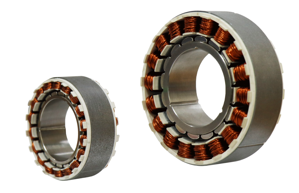

The KBM frameless motor series from Kollmorgen features direct-drive technology. In fact, all KBM frameless brushless motor models are engineered to provide high-performance and simple installation. Optional latching digital Hall effect sensors are pre-aligned and factory installed with added axial rotor length for proper triggering. Choice of insulation allows operation over a wide range of line input voltage. Image: Kollmorgen

These Akribis ADR-T Series motors are frameless rotary direct-drive motors. Such torque motors along with linear motors are direct-drive solutions. Image: Akribis Systems
