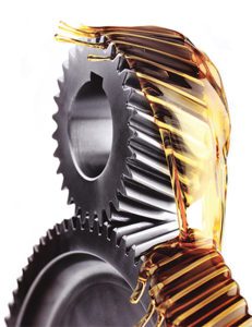

gearbox lubricationLike other types of rotating equipment, gearboxes rely on lubrication to reduce friction and provide cooling for optimal operation and life. Gearbox manufacturers provide recommendations for the type of lubrication to be used and the typical lubrication intervals, but the actual gearbox lubrication requirements depend on the environmental conditions the gearbox is exposed to, whether it is properly maintained, and whether it experiences overloading.
There are several methods for lubricating a gearbox, with the most common being grease lubrication, oil splash, and forced oil.

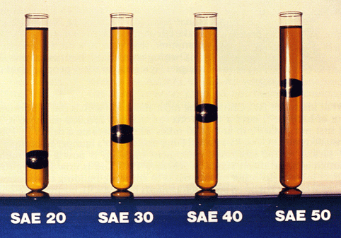

Regardless of the lubrication method used, the right type of lubrication is critical to gearbox performance. And of the parameters involved in selecting a lubricant, viscosity is the most important.
A lubricant with a viscosity that is too high for the application (i.e. the lubricant is too “thick”) won’t flow sufficiently as the gear teeth engage to protect mating surfaces and provide cooling. But lubrication with a viscosity that’s too low won’t provide a sufficient film thickness to prevent metal-to-metal contact between the mating surfaces.
gearbox lubrication
Oils with lower viscosity are often referred to as “thinner,” such as the SAE 20 oil on the left. Lower viscosity allows oil to flow over surfaces, but may not provide a sufficient film thickness to prevent metal-to-metal contact.
