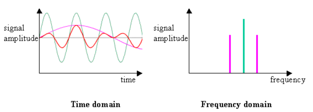

Every waveform can be expressed as the sum of simple sine waves with varying amplitudes, phases, and frequencies. A Fourier transform is a mathematical process that converts a time domain waveform into these individual sine wave components in the frequency domain — a process often referred to as “spectrum analysis” or “Fourier analysis.”
To understand fast Fourier transforms, it’s helpful to first understand the underlying process, known as discrete Fourier transform (DFT). A discrete Fourier transform tests the time domain waveform for discrete, or individual, frequencies based on the length of the signal (N). The number of frequencies, or samples, required is equal the signal length squared (N2). Even for small signals, this can take significant time and computing power. To make the Fourier transform faster and more efficient, a method known as the fast Fourier transform is used.
The complex signal (red) is made up of simple sine waves (pink and green). A fast Fourier transform expresses these sine waves in the frequency domain, where high amplitudes at certain frequencies become apparent.
Image credit: National Instruments
Fast Fourier transforms (FFT) significantly reduce the number of complex calculations that must be undertaken by assuming that N (the length of the signal) is a multiple of 2. The underlying mathematics of this assumption eliminates redundant calculations and those that have no value (multiplying by “1” for example), which provides significant computational efficiencies and reduces the number of required samples to N*log2(N) — an amount significantly less than N2. This allows fast Fourier transforms to provide close approximations of the more time-consuming discrete Fourier transforms, but with significantly faster computing time.
