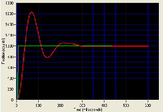

Why inertia ratio is important
If the motor inertia is too low relative to the load inertia, the load will essentially try to “drive” the motor, causing overshoot and resonance. In order to effectively control the load, the motor will need to draw higher current than should be necessary, which decreases efficiency and increases operating costs.
On the other hand, if the motor inertia is too high relative to the load inertia, the motor is oversized, meaning that it was more costly than necessary and uses more energy than needed for the application.
gear ratio
Adding a gearbox to a servo system helps to achieve the desired load-to-motor inertia ratio.
Image credit: Lenze
A perfect inertia ratio of 1:1 is often impractical and, in many applications, unachievable. And most applications operate well with an inertia ratio of 5:1, 10:1, or even 100:1 or higher in some cases. The “best” inertia ratio depends on a variety of application-specific factors, including the system dynamics (acceleration and deceleration), the required positioning accuracy, and the amount of overshoot and settling time that can be tolerated.
The rule of thumb goal for inertia matching, recommended by most servo sizing guidelines, is 10:1 or less. But in reality, the “best” inertia ratio is specific to each application, and may be lower than 10:1 for applications with high dynamics and high precision requirements, or much higher than 10:1 for applications with high feedback resolution and fast response times to rapidly correct errors and avoid instability.
