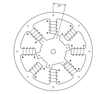

switched reluctance motors
A typical 8/6, four-phase switched reluctance motor. Notice that when rotor poles 3 and 6 are aligned with stator poles B and B’, all other rotor poles are out of alignment with the stator poles.
Image credit: scienceprog.com

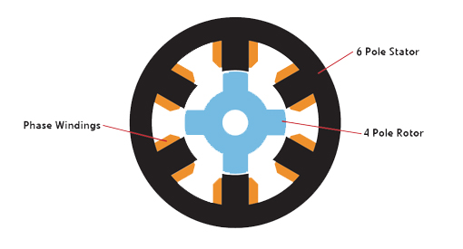

Switched reluctance motor with 6 stator poles and 4 rotor poles. Notice that the stator poles protrude toward the rotor, and the rotor poles protrude toward the stator. This is known as a doubly salient pole design.
Image credit: chargedevs.com
