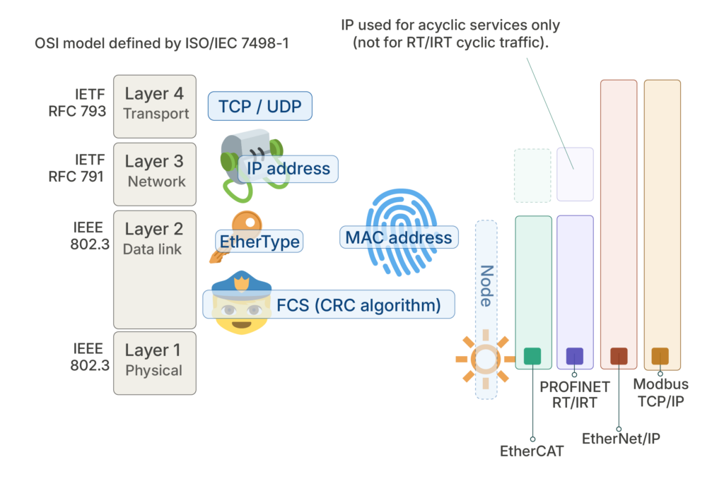

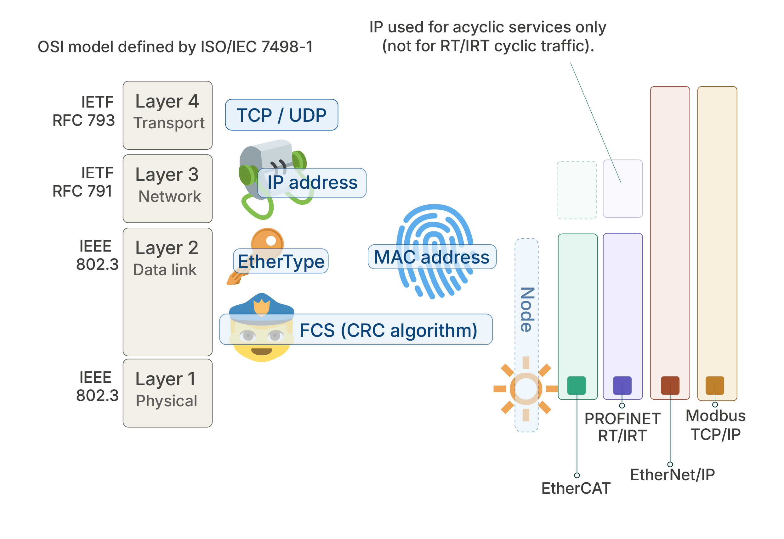

Here we relate Ethernet terms to common industrial protocols.
Cyclic redundancy checks or CRCs are the mathematical algorithm used to detect errors in data transmission yielding a frame check sequence or FCS — a 4-byte field at the end of a frame that carries the CRC result. The FCS on the outer Ethernet frame is separate and independent check covering the entire frame. Any frames that fail CRC are just dropped.
Here are the first four layers of the OSI model.

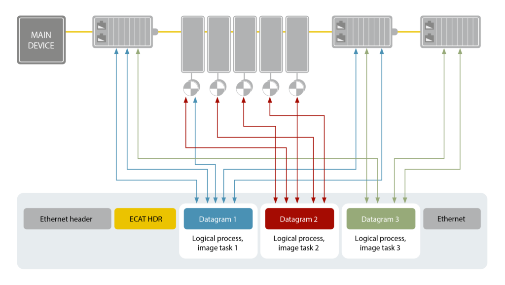

With EtherCAT, every subdevice effectively checks the frame in both directions. A subdevice detecting an error modifies the FCS so downstream subdevices recognize it’s already flagged … and that way, the main device can easily pinpoint the erroring network segment.

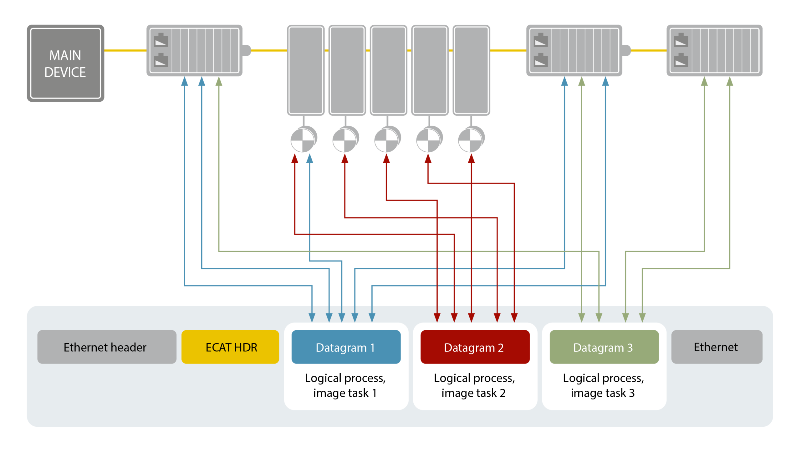

The process image is a realtime snapshot of the entire network’s state held in a block of memory. Image: ETG
In fact, EtherCAT makes a second integrity check. Every EtherCAT subdevice proofs and regenerates verification on its own datagram embedded within the circulating frame’s payload. The working counter or WKC is a 16-bit integer appended to each datagram — not the Ethernet frame itself. Every sub that successfully employs a command increments the WKC so read and write operations each add one and a read-write adds three. Then the EtherCAT main compares the WKC it gets back against what’s expected. Any mismatch indicates at least one sub in the logical process image didn’t participate as expected due to being unreachable, in the wrong state, or encountering some error.
Both this check (and subs parsing frame content) and the FCS happen on the data link for sophisticated per-hop error detection on Layer 2 without IP involvement.

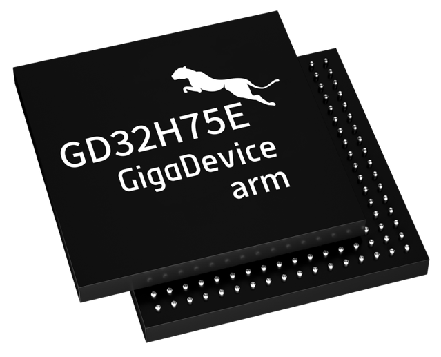

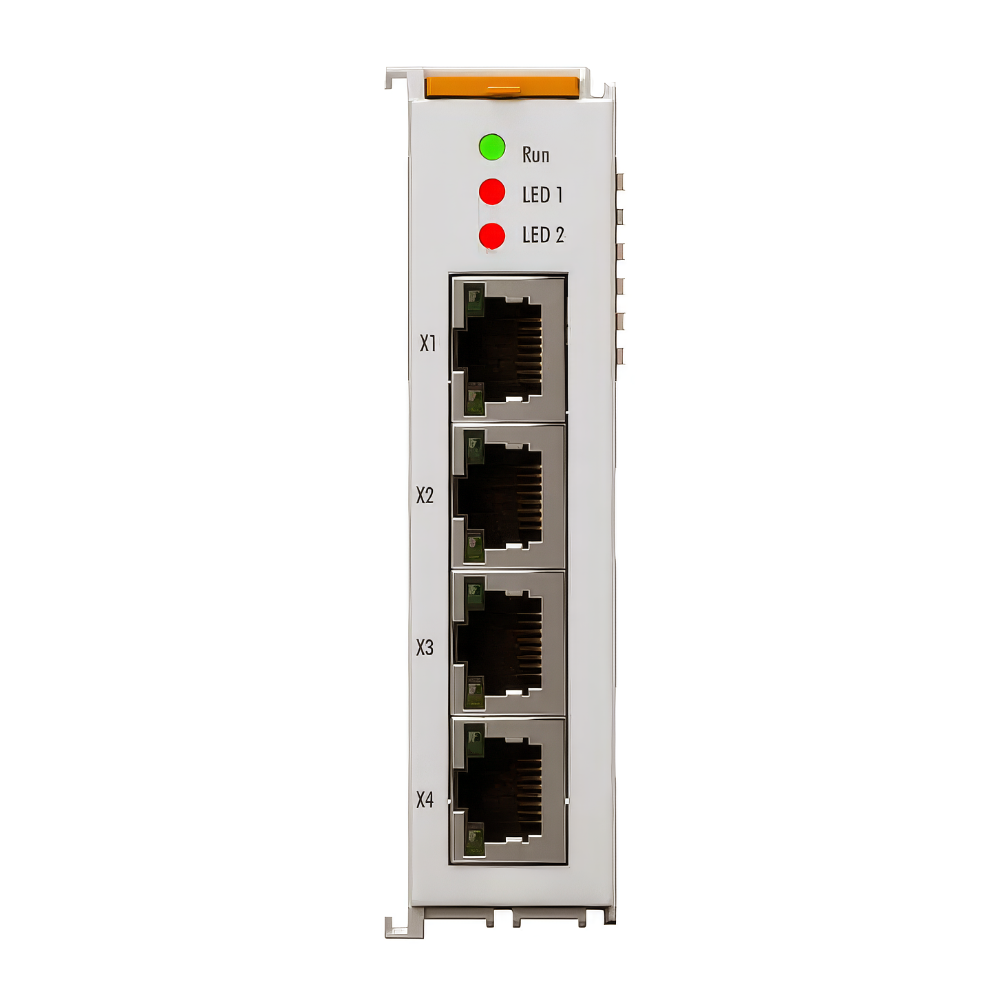

The GigaDevice Semiconductor GD32H75E MCU integrates an EtherCAT subdevice controller along with two Ethernet PHYs for high-precision multi-axis coordination and low-latency communication to serve in servodriven applications.
In EtherCAT, except for connections to enterprise-level systems, there are no standard switches … and each EtherCAT device has an internal processing ASIC called an EtherCAT subcontroller or ESC with forwarding logic. Then two or more Ethernet ports (RJ45, M8, or fiber) allow connection to the previous node and next node in the network.
This makes for a self-terminating network, as any node not detecting a “next node” automatically becomes the terminus … and “boomerangs” the data-transmit stream back as a data-receive stream. Hence EtherCAT networks can be wired in star, line, tree, or ring topologies.
For Ethernet IT communication between subdevices, EtherCAT can tunnel TCP/IP connections through a mailbox channel without impacting realtime data transfer.
Consider what’s possible with EtherCAT microcontroller units or MCUs that forward frames on-the-fly without any switching logic — in contrast with PROFINET IRT and even EtherNet/IP Device Level Ring MCUs that need to embed an actual switch chip in each node.
Some EtherCAT MCU chip makers are imparting their products with more Ethernet physical layer transceiver or PHY connectivity to bridge the physical layer (electrical signals) and digital layer (the digital signals they become) sans any separate FPGA or ASIC (such as Beckhoff’s ET1100). The GigaDevice chip is an integrated EtherCAT subdevice controller with two built-in Ethernet PHYs for use in servomotor applications such as humanoid robotics (to give one example).
Besides the flexibility in topology, EtherCAT also avoids the delays and timing issues of certain store-and-forward switch communication that must receive and verify (via the FCS) frames before forwarding them onward. What’s more, EtherCAT systems don’t need installers to buy, wire, configure, and maintain dedicated switches or Ethernet devices with this circuitry.

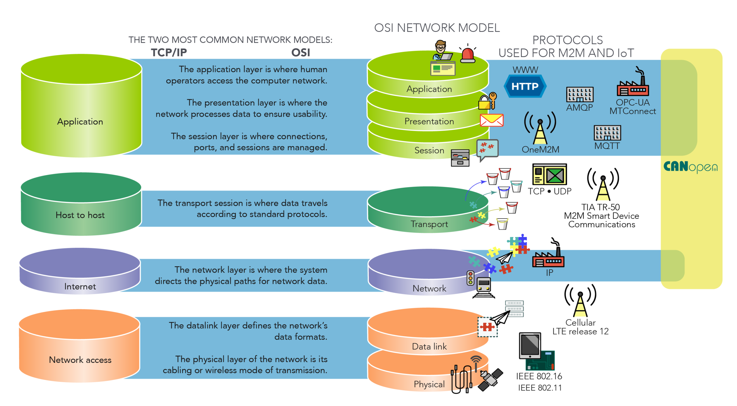

The two most common models used to describe networks are the OSI model and the TCP/IP model. Modern networking protocols (and the application layer) are often described using OSI. In contrast, three-layer IoT models place the application layer above perception and network layers; four-layer models place it above data processing, network, and sensing layers. Five-layer IoT protocol models are similar but add processing and enterprise layers.
In this way, EtherCAT avoids trojan and virus malware exposure via IP at its subdevices so can be handled like a fieldbus instead of IT infrastructure. The main must be protected, but an EtherCAT main is typically a PC running Windows or Linux much like those running the most critical infrastructure today … including cloud, banking, and government systems. So, engineers can secure EtherCAT main devices with the same tools and methods used to secure Windows or Linux servers: Put it on a domain, use Active Directory, apply normal IT security policies with familiar patching and hardening strategies.

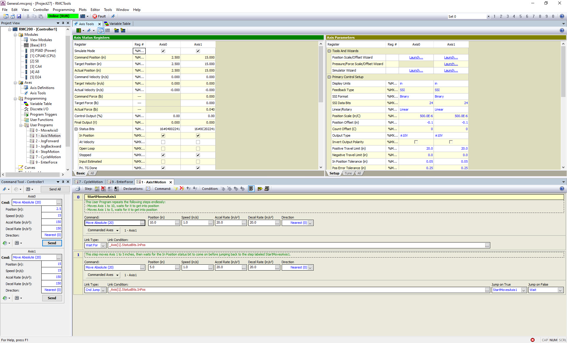

The Delta Motion RMCTools integrated development environment supports motion design work with EtherCAT subdevices under the command of the RMC200 and ECAT communications module.
