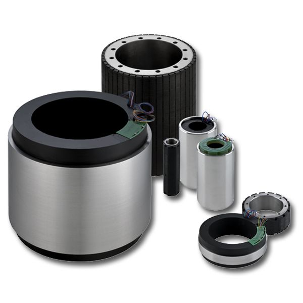

TBM2G frameless motors image courtesy Kollmorgen
Selected motor and drive performance values: Let’s assume we selected a frameless brushless motor with a Kt(rated temp) = 2.19_Nm/Arms; Kb(25°C) = 133_Vrms/kRPM; Jm = 0.00304_kg·m2; Tpk(motor) = 76.1_Nm; Rm(L-L) = 1.41 Ω (for Rm cold or ambient temperature).
The KBM frameless motor series from Kollmorgen — including the KBM-35H03-A motor upon which values in this article are based — is a direct-drive technology. In fact, all KBM frameless brushless motor models are engineered to provide high-performance and simple installation. Optional latching digital Hall effect sensors are pre-aligned and factory installed with added axial rotor length for proper triggering. Choice of insulation allows operation over a wide range of line input voltage.
