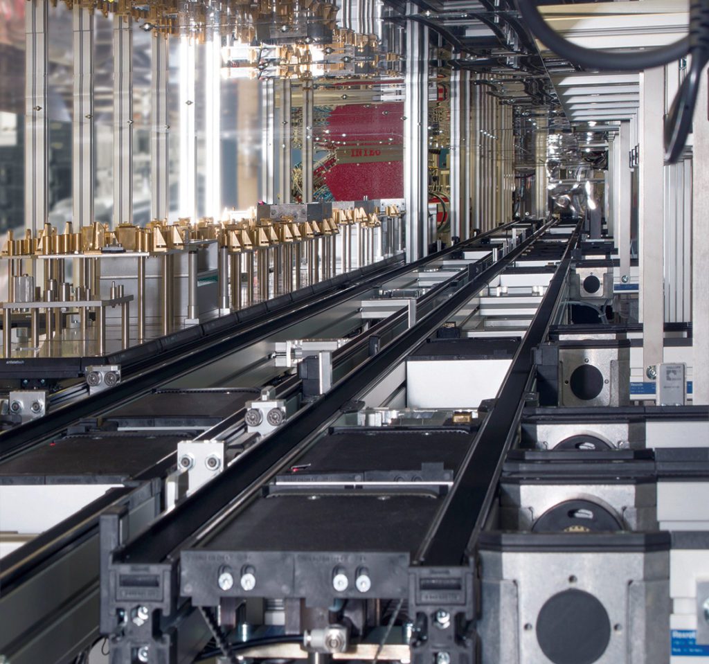

The Rexroth ActiveMover linear motor conveyor system serves as an alternative to traditional power and free pallet-based assembly conveyors in select light-payload applications than can justify the upfront cost. Linear motor conveyors (also called intelligent track or transport systems) are suitable for moving items at high speed and positioning accuracy.
Each pallet in this Rexroth ActiveMover system includes collision avoidance and has the ability to travel both forward and backward, independent of other pallets in the system, to precisely defined positions.  With speeds up to acceleration up to 40 m/sec2 and 150 m/min., linear-motor driven conveyors excel in ultra-high-speed pallet-based assembly applications.

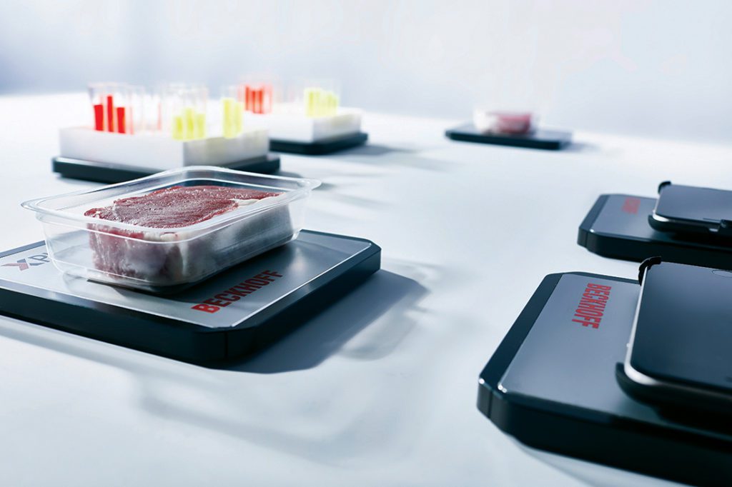

Providing unlimited paths via flying motion, the XPlanar system from Beckhoff levitates magnetic movers with six degrees of motion.
In contrast, planar motors use the electromagnetic behavior of its motors for both the movement and suspension of loads … which is why they’re occasionally called magnetic levitation (maglev) stages.
In many cases, planar motors include coils in stationary tiles and magnets in its free-floating mover. This allows the mover to remain untethered by connections for cooling, controls, and power supplies.
Special capabilities of planar motors include the ability to limitlessly tilt and rotate movers.
Developed in the early 2000s, the technology until now hasn’t been practical for real-world use. But a series of planar motors from Beckhoff (in the XPlanar family) is now in beta testing … though Johnson points out that many of motors’ functional capabilities are already possible with linear transport systems and other more traditional motion solutions.
“Our planar motor maintains traceability while providing an infinite number of paths that products or packages can travel,” says Johnson. “This flying motion system levitates magnetic movers with six degrees of motion up to 5 mm above planar motor tiles — for contact and wear-free operation.”
Most impressive is that TwinCAT 3 for machine learning (and optimization) along with high data throughput (via EtherCAT G connectivity) lets the system automatically determine the most efficient path to get an item to its destination.
“Then it can calculate the route — avoiding collisions with other movers and stopping at other workstations for the individual item … whether it requires an assembly step or special labeling or customization,” says Johnson. “XPlanar does this in real time, which is why a high-end control platform and the data throughput of EtherCAT G are important.”
