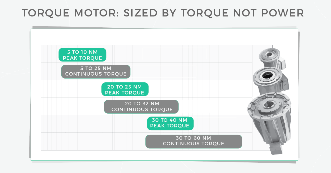

In contrast with traditional drive sizing and specification, the selection of torque motors isn’t based on power but rather torque. Peak torque is the motor’s maximum torque possible for short periods; continuous torque is the torque the motor can supply indefinitely as long as its mounting is correct for proper cooling. Application duty cycle dictates the levels of peak and continuous torque needed to affect the overall motion design goals. Visit motioncontroltips.com/category/integrated-motion-systems/rotary-tables for more on one common application for torque motors — that of direct-drive rotary tables.
