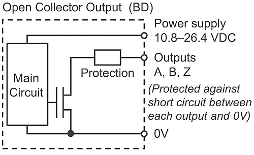

A second output type is an Open Collector, or an NPN transistor (Figure 3). NPN Open Collector encoders “sink” current from sourcing (PNP) PLC or motion controller inputs. Sinking and sourcing inputs simply refer to the current flow in a transistor. A NPN encoder requires a PNP PLC or motion controller input, as the encoder sinks current that is sourced by the PLC or motion controller. NPN encoders require one power lead, one wire per channel (A, B, Z), and one 0 V (dc common) wire for all the current return.
open-collector-NPN-encoder
Figure 3. An NPN (open collector) incremental encoder requires the automation system to have PNP (sourcing) inputs.
An Open Collector encoder has A, B, Z, and 0 V wires (and a wire for +dc to power the electronics). NPN Open Collector (sinking) encoders require the master PLC or motion controller to have PNP (sourcing) inputs. Open collector encoders usually accept a wide range of voltage.

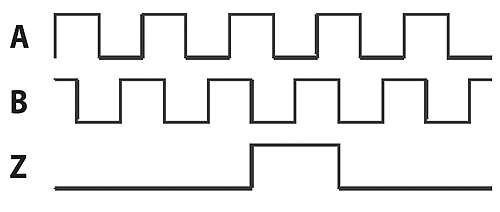

Z-pulse or the Index Channel
Certain incremental encoders have another channel called the Index Channel or Z-pulse (zero position pulse). This output pulses once per revolution of the encoder, and it is used to indicate when the encoder disc crosses the fixed zero position inside the encoder (Figure 6).
timing-diagram-for-a-5-ppr-encoder
Figure 6. This timing diagram is for a 5 PPR encoder. Notice that the Z pulse stays on for one entire cycle of output B.
The Z-pulse can be used to reset a counter, or it can be used for very precise homing. For example, consider a servo drive that uses an incremental encoder as a feedback device. The servo can home to an external signal (a proximity switch, mechanical limit switch, etc.), then proceed to the next occurrence of the encoder’s Z-pulse for extremely accurate positioning.
Typically, the encoder’s Z-pulse is factory set and cannot be moved. However, several families of encoders offer “servo mounting clamps” that allow the body of the encoder to be rotated, or “clocked,” after installation, so the Z-pulse signal occurs in the desired position relative to a machine function.
