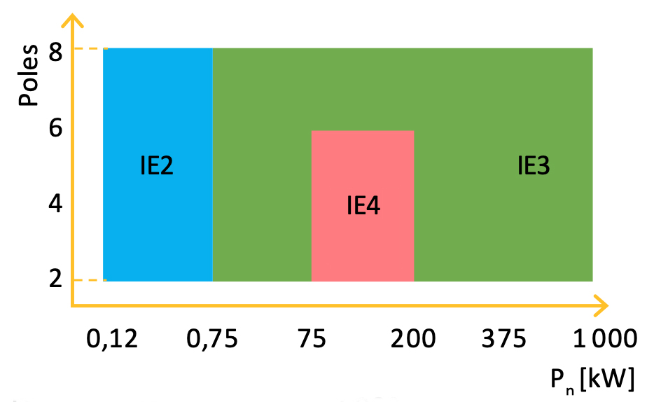

Efficiency requirements that take effect on July 1, 2023:
Efficiency of IE2 required for:
  • Ex eb increased safety motors with rated output equal to or greater than 0.12 kW up to and including 1000 kW, with 2, 4, 6, or 8 poles
  • Single-phase motors with rated output equal to or greater than 0.12 kW
Efficiency of IE4 required for:
  • Three-phase motors that are not brake motors, Ex eb increased safety motors, or other explosion-protected motors, with a rated output equal to or greater than 75 kW up to and including 200 kW, with 2, 4, or 6 poles
(EU) 2019/1781 Efficiency Regulations
Efficiency regulations that take effect on July 1, 2023.
Image credit: zvei.org
