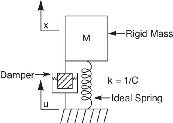

Passive vibration damping systems often employ a mechanical device or a fluid to reduce vibration, but passive damping can also be achieved with viscoelastic materials. In either case, the kinetic energy of the vibration is converted to heat. Because many types of damping systems have inherent resonances, they are primarily effective at frequencies higher than 4 Hz. Passive vibration dampers also tend to have trouble compensating for vibrations that occur in more than one direction — in other words, they are most effective for vibrations that occur only in the X, Y, or Z direction, and less so for vibrations that occur in multiple directions simultaneously.
vibration damping
Shown here is an example of a passive vibration damping system, consisting of a simple harmonic oscillator (a rigid mass and a spring) with an added damper. The damper removes mechanical energy from the system in the form of heat.
Image credit: Newport Corp.
