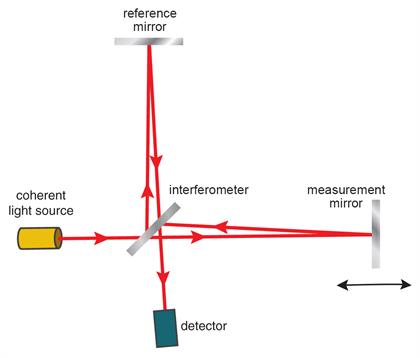

The basic setup for a laser interferometer requires a beam source, mirrors, and detectors.

Interferometric laser encoders — also referred to as laser interferometer encoders or laser displacement sensors — interpret the interference of two laser beams to determine the position or motion of a target object. The operating principle relies on a laser source whose beam is split into two beams that are identical but directed along different paths.
One beam is sent to a reference mirror while the other is sent to a mirror on the object being measured (the measurand). The two beams are then reflected back by their respective mirrors and combine before reaching a detector. However, the differing travel distances of the two beams puts them out of phase, so when they’re recombined, they create an interference pattern.
The interference can be constructive, where the combined wavelengths produce a bright fringe, or destructive, where the combined wavelengths produce a dark fringe. This variation in the intensity of the combined light is cyclic, and one cycle of variation occurs every time the measurement beam (and, therefore, the measurand) is displaced by one-half of laser’s wavelength. The detector uses this variation in intensity and its relationship to the laser’s wavelength to determine the amount of movement of the measurand.
