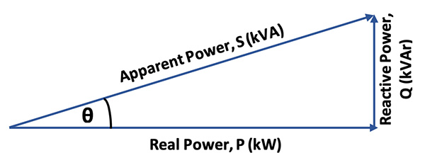

To understand apparent power, it helps to visualize it (together with real and reactive power) on a power triangle. The power triangle is a right triangle, where the real power and reactive power are at right angles to each other, and apparent power is the hypotenuse. The power factor is the cosine of the angle θ (the angle between the real and apparent power). Since the cosine is found by dividing the adjacent leg of the triangle by the hypotenuse, the power factor is the real power divided by the apparent power.

The angle θ represents the displacement, or phase difference, between the voltage and current. The reactive power required for inductive loads tends to pull current and voltage out of phase, resulting in a larger angle θ and, therefore, a lower power factor.
If there is no phase difference between voltage and current, the angle θ is zero. The cosine of zero degrees is 1 (cos(0) = 1), so the power factor is 1. On the other hand, if the voltage and current are out of phase by 90 degrees, θ equals 90. The cosine of 90 degrees is zero (cos(90) = 0), so the power factor is zero!
Although the real power consumed by an AC induction motor varies with the motor’s load, the amount of reactive power the motor uses remains constant regardless of the load. You can see from the power triangle that to increase the power factor (reduce the angle θ), the reactive power needs to be reduced.
