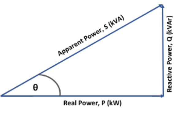

Recall that in an AC induction motor, power is supplied directly to the stator and a magnetic field is induced in the rotor. The power supplied to the stator is referred to as “real,” or “active” power because it produces torque. The power used to induce the magnetic field in the rotor is referred to as “reactive” power because it does not actively produce work. The combination of real power and reactive power is referred to as “apparent” power. Real, reactive, and apparent power are often depicted on a power triangle.
power factor
In an ideal system, power factor (PFD) is the cosine of θ, which equals real power (P) divided by apparent power (S).

Note the subscript, D, in the power factor notation. In the power triangle, θ represents the displacement (phase difference) between voltage and current. Thus, this expression of power factor is often referred to specifically as the displacement power factor, PFD.
For resistive loads, all (or nearly all) of the power used is real power that produces useful work — heat or light, for example. Therefore, current and voltage remain in phase (θ = 0), and the power factor is near unity (i.e., 1). But the reactive power required for inductive loads — to induce a magnetic field in a rotor, for example — tends to pull the current out of phase with the voltage (hence, a larger θ angle), causing a lower power factor.
