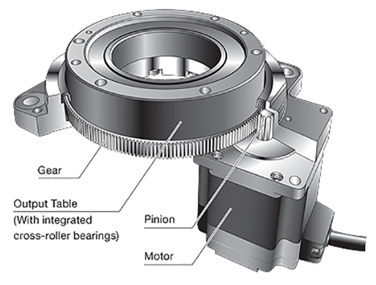

There are two main design principles for rotary actuators: those that incorporate a mechanical drivetrain — such as a belt or gear — to transfer motion from the motor output to a rotating table, and those in which the motor is directly coupled to the rotating table. In either case, an absolute or incremental rotary encoder is often integrated into the actuator assembly, and brakes are typically offered as standard options. To support the rotating load, most designs use either a rotary ball bearing or a radial (ring-style) crossed-roller bearing.
The first type — those that use a mechanical drivetrain — most often use a belt, worm gear, or pinion gear coupled to a servo or stepper motor. In the case of belt-driven versions, gearing (torque multiplication and speed reduction) can be achieved through additional gear components or by using different diameters for the motor and table pulleys.
rotary actuators
Rotary actuators with mechanical drivetrains offer many options for configuration.
Image credit: Oriental Motor
