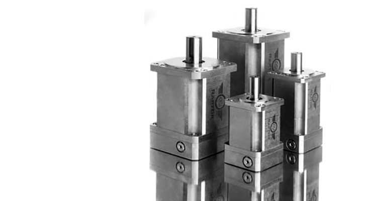

Raptor SS precision planetary gearheads from CGI Motion are washdown-ready.
