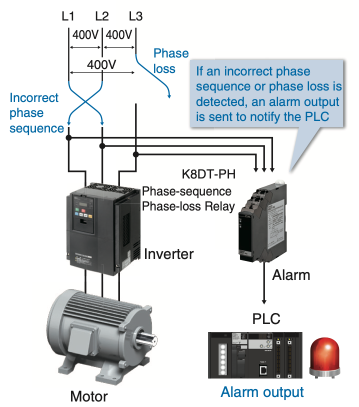

Three-phase voltage monitoring relays, or phase monitoring relays, monitor additional phase parameters along with over- and under-voltage conditions: namely, phase imbalances, phase loss, and phase sequence (also referred to as phase reversal).
In three-phase systems, over- and under-voltage conditions occur when the voltages in all three of the phases increase or decrease simultaneously. To determine whether there is an over- and under-voltage condition, the relay measures the average voltage of all three lines and compares this to the voltage set point.
Phase monitoring relays can detect phase loss, phase sequence, and phase imbalance in three-phase systems.
Image credit: Omron
To determine if a phase imbalance is present, the relay monitors each of the phases to detect when the voltage in any one phase falls by a predetermined amount below the average of all three phases. Similarly, if complete loss of a phase is detected, the relay will trip and disconnect power from the motor.
Phase imbalances force some of the motor windings to carry more of the load than others, which can cause the motor to experience excessive heat. If a motor experiences phase loss, it can continue to operate by drawing the required current from the remaining phases, but this also causes excessive heat and can damage the motor.
Changing the sequence of any two of the three voltage phases — known as phase reversal — can be extremely dangerous, as it will cause a change in rotational direction for connected equipment such as motors, fans, or pumps. To monitor phase reversal, the relay simply monitors the sequence of the three phases and trips if it deviates from the defined sequence.
