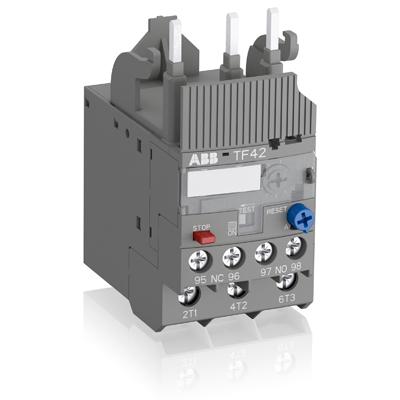

electronic thermal overload relays
Electronic thermal overload relays are more accurate and reliable than heater designs, and they can provide data for diagnostics and preventive maintenance.
Image credit: ABB
Electronic thermal overload relays measure current electronically, rather than relying on a heater mechanism, and so are insensitive to changes in ambient temperature. They’re also less prone to “nuisance,” or false, tripping. Electronic overload relays can provide data such as the percentage of thermal capacity utilization (%TCU), percentage of full-load amps (%FLA), time-to trip, current RMS, and ground fault current — information that can help operators conduct diagnostics and predict when the relay is at risk of tripping.
Electronic designs can also protect motors against phase loss (also referred to as phase failure), which occurs when one phase of current equals zero amps, often due to a short circuit or blown fuse. This causes the motor to draw excessive current on the remaining two phases and leads to significant motor heating.
