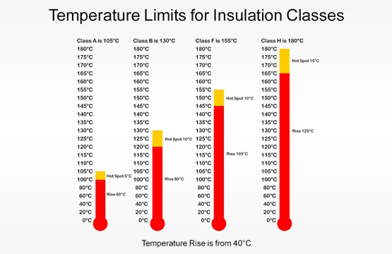

How motor insulation classes are determined
The NEMA insulation classes specify the maximum allowable temperature of the motor winding insulation — under continuous operation — that will provide a life of 20,000 hours.
The maximum allowable temperature assumes an ambient temperature of 40° C and adds to that an allowable temperature rise plus an additional amount (often referred to as thermal margin) to allow for hotspots within the windings.
From a maximum ambient of 40 degrees C, the allowable temperature rise and the hotspot allowance add to give the maximum allowable temperature for each insulation class.
Image credit: The Snell Group
In addition to a maximum ambient temperature of 40° C, the insulation class ratings also assume a service factor of 1.0 and an altitude of 3300 feet above sea level (beyond which, the thinner air has a reduced cooling capacity). However, adjustment tables and calculations are available to determine the reduced maximum operating temperature for conditions outside of those specified by the insulation class. For example, if the ambient temperature is higher than 40° C, the allowable temperature rise should be reduced by the amount that the ambient temperature exceeds 40° C.

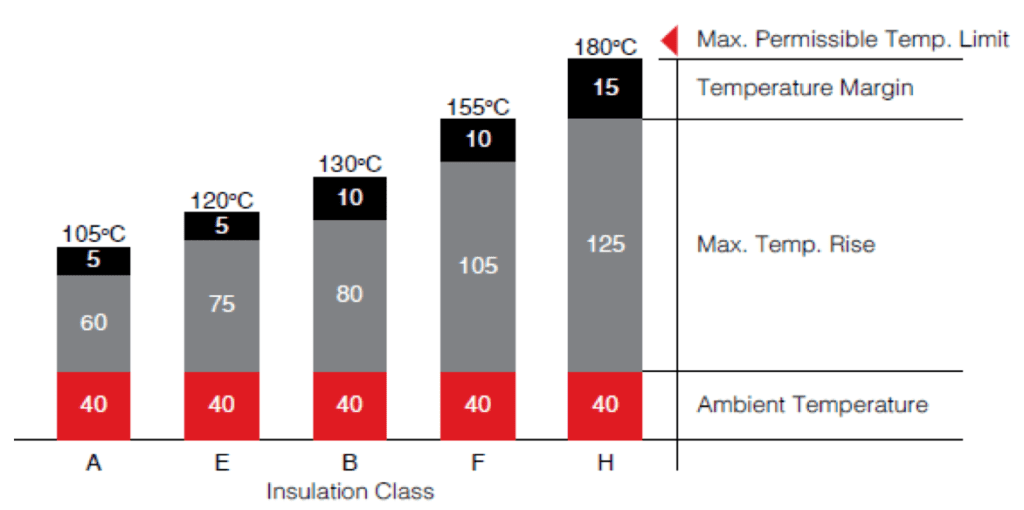

NEMA vs IEC insulation classes
Although the NEMA insulation classes are widely recognized in North America, the IEC 60034-1 standard is often used for motors made or sold outside of North America. The IEC ratings align with the NEMA ratings for classes A, B, F, and H, but add an additional rating of class “E.”
IEC 60034-1 motor insulation classes align with the NEMA classifications, with the addition of a class “E” rating.
