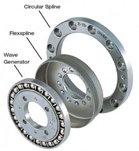

Strain-wave gearing is a special gear design for speed reduction. It uses the metal elasticity (deflection) of a gear to reduce speed. (Strain-wave gearing sets are also known as Harmonic Drives, a registered trademark term of Harmonic Drive Systems Inc.) Benefits of using strain-wave gearing include zero backlash, high torque, compact size and positional accuracy.
A strain-wave gearset consists of three components: wave generator, flexspline and circular spline.
The wave generator is an assembly of a bearing and a steel disk called a wave generator plug. The outer surface of the wave generator plug has an elliptical shape machined to a precise specification. A specially designed ball bearing is pressed around this bearing plug causing the bearing to conform to the same elliptical shape of the wave generator plug. Designers typically use the wave generator as the input member, usually attached to a servomotor.

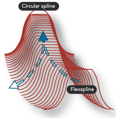

This is a progression of flex-spline tooth engagement with circular-spline teeth. The profile of Harmonic Drive gear teeth lets up to 30% of the teeth engage ... for higher stiffness and torque than gearsets with involute teeth.
This is a progression of flex-spline tooth engagement with circular-spline teeth. The profile of Harmonic Drive gear teeth lets up to 30% of the teeth engage … for higher stiffness and torque than gearsets with involute teeth.
The flexspline is a thin-walled steel cup. Its geometry lets the walls of the cup be radially compliant but remain torsionally stiff (because the cup has a large diameter). Manufacturers machine the gear teeth into the outer surface near the open end of the cup (near the brim). The flexspline is usually the output member of the mechanism.
The cup has a rigid boss at one end to provide a rugged mounting surface. The wave generator is inserted inside the flexspline so the bearing is at the same axial location as the flexspline teeth. The flexspline wall near the brim of the cup conforms to the same elliptical shape of the bearing. This conforms the teeth on the outer surface of the flexspline to the elliptical shape. That way, the flexspline effectively has an elliptical gear-pitch diameter on its outer surface.
The circular spline is a rigid circular steel ring with teeth on the inside diameter. It is usually attached to the housing and does not rotate. Its teeth mesh with those of the flexspline. The tooth pattern of the flexspline engages the tooth profile of the circular spline along the major axis of the ellipse. This engagement is like an ellipse inscribed concentrically within a circle. Mathematically, an inscribed ellipse contacts a circle at two points. However, the gear teeth have a finite height. So there are actually two regions (instead of two points) of tooth engagement. Roughly 30% of the teeth are engaged at all times.
The elastic radial deformation acts like a very stiff spring to compensate for space between the teeth that would otherwise increase backlash.
The pressure angle of the gear teeth transforms the output torque’s tangential force into a radial force acting on the wave-generator bearing. The teeth of the flexspline and circular spline engage near the ellipse’s major axis and disengage at the ellipse’s minor axis. Note that the flexspline has two less teeth than the circular spline, so every time the wave generator rotates one revolution, the flexspline and circular spline shift by two teeth. The gear ratio is calculated:

The tooth engagement motion (kinematics) of the strain wave gear is different than that of planetary or spur gearing. The teeth engage in a manner that lets up to 30% of the teeth (60 for a 100:1 gear ratio) engage at all times. This contrasts with maybe six teeth for a planetary gear, and one or two teeth for a spur gear.
In addition, the kinematics enable the gear teeth to engage on both sides of the tooth flank. Backlash is the difference between the tooth space and tooth width, and this difference is zero in strain-wave gearing.

As part of the design, the manufacturer preloads the gear teeth of the flexspline against those of the circular spline at the major axis of the ellipse.
The teeth of the Flexspine and Circular Spline engage near the major axis of the ellipse and disengage at the minor axis of the ellipse.
The preload is such that the stresses are well below the material’s endurance limit. As the gear teeth wear, this elastic radial deformation acts like a stiff spring to compensate for space between the teeth that would otherwise cause an increase in backlash. This lets the performance remain constant over the life of the gear.
Strain-wave gearing offers high torque-to-weight and torque-to-volume ratios. The lightweight construction and single-stage gear ratios (of up to 160:1) let engineers use the gears in applications requiring minimum weight or volume. Small motors can exploit the large mechanical advantage of a 160:1 gear ratio to create a compact, lightweight and low-cost package.
Another tooth profile for strain-wave gearing is the S tooth design. This design lets more gear teeth engage. The effect is to double torsional stiffness, double peak torque ratings and lengthen operational life. The S tooth form doesn’t use the involute curve of a tooth. Instead, it uses a series of pure convex and concave circular arcs that match the loci of engagement points dictated by theoretical and CAD analysis.
The increased root filet radius makes the S tooth much stronger than an involute curve gear tooth. It resists higher bending (tension) loads while maintaining a safe stress margin.
