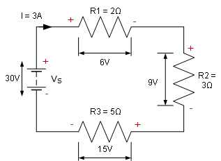

Finding equivalent resistance for series circuits
For a circuit wired in series, Kirchhoff’s voltage law, KVL, tells us that the voltage around the circuit will equal zero. This means the sum of the voltage drops across each resistor will equal the supply voltage. For a series circuit with three resistors, the supply voltage, Vs, equals the sum of the voltages across the three resistors (VR1, VR2, and VR3):
equivalent circuit equation and KVL
We know from Kirchhoff’s current law, KCL, that the charge flowing into any node equals the charge flowing out of that node. Series circuits have only one node (junction), so current is the same at all points in the circuit. This means the same current flows across each resistor. Using Ohm’s law, V = IR, to express the voltage across each resistor, we can rewrite the equation above:
Now we can see that the equivalent resistance is simply the sum of all the resistances in the series circuit.
equivalent resistance series circuit
And voltage can now be written in terms of the equivalent resistance.
The example below shows a series circuit with three resistors.
series circuit
For this circuit, the equivalent resistance is:
So the equivalent circuit will have one, 10-ohm equivalent resistor (Req).
series equivalent circuit
We can check our equivalent circuit by calculating the voltage across the equivalent resistor and ensuring it equals the supply voltage:
