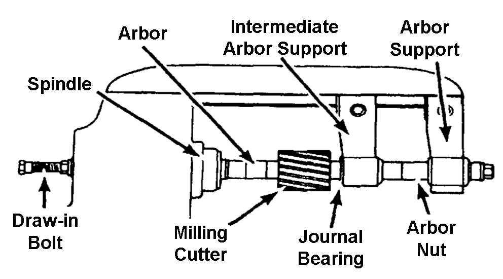

On a typical machine tool, the tool that performs the machining operation (cutting, milling, or boring, for example) is attached to a rotating spindle that drives the tool. But on machines that require long machining lengths, such as milling and boring, the tool is mounted to an arbor. The arbor is driven by the spindle and provides the necessary length for the tool to reach the workpiece in these operations.
machine tool vibration
On some machine tools, the tool is attached to an arbor, which is driven by the spindle.
Horizontal milling machines are often referred to as “arbor milling machines” because their design requires the use of an arbor to achieve the proper tool position.

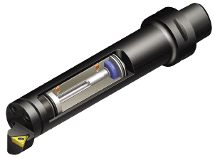

To address the problem of vibration in machine tools, some manufacturers have even developed vibration-damping arbors that significantly reduce vibration, allow longer machining lengths (L/d ratio of 8 or greater), and cut down on machining times.
Vibration damping technologies differ among manufacturers, but most are based on passive, tuned mass dampers.
Image credit: Sandvik Coromant
While each manufacturer uses a proprietary damping technology, most vibration-damping arbors are based on passive tuned mass damping systems, consisting of a mass, a set of springs, and a damper. Multiple springs (or, similarly, several materials with frequency-dependent stiffness) are used to address various frequencies that occur during machining.
The frequencies of the tuned mass damping system are designed to match the structural frequencies to be eliminated. So when any of the specified frequencies is excited, the damper resonates out of phase with the structure, absorbing or dissipating the kinetic energy caused by vibrations.
