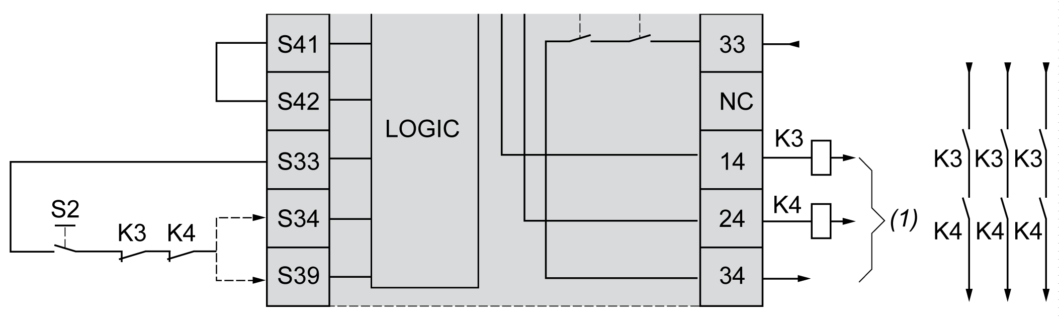

External device monitoring can be implemented as either one-channel monitoring or two-channel monitoring. One-channel monitoring uses contacts that are wired in series, with feedback provided to the start condition of the safety device. Two-channel monitoring requires that the contacts be wired independently, and both NC contacts must be closed before the safety device can be reset. While one-channel monitoring can detect a malfunction in the operation of the contacts, two-channel monitoring can also detect a malfunction in the safety circuit wiring.
one-channel external device monitoring
With one-channel monitoring, the contactors (K3 and K4) are connected in series.
Images credit: Schneider Electric
