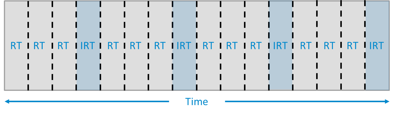

In a hard real-time network, the network bandwidth is divided into time slices, with some time slices allocated for hard (isochronous) real-time traffic (IRT), and the rest allocated to standard real-time (RT) traffic. When the isochronous real-time (IRT) time slices come into play, the network buffers and holds the standard real-time (RT) traffic, allowing only the IRT frames to pass through. (The bandwidth, or time slices, reserved for IRT traffic are just long enough for the IRT communications, so that standard RT traffic is not unnecessarily delayed.) Once the IRT frames are clear, the network resumes standard RT traffic.
Time slices divide the network bandwidth into segments for isochronous real-time (IRT) communications and standard real-time (RT) communications.
