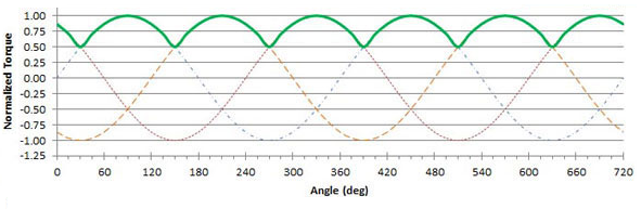

Torque ripple
The result of cogging torque is a variation in torque production — referred to as torque ripple — that occurs when the motor is energized with constant current. Due to the nature of the interaction between the magnetic fields of the rotor and the stator (described above), torque ripple varies sinusoidally. At high speeds, it is often filtered out by the inertia of the system, but at lower speeds, torque ripple can cause unwanted speed fluctuations, vibrations, and audible noise.
cogging torque
Torque ripple (green) varies sinusoidally due to the interaction between magnetic fields of the stator and rotor.

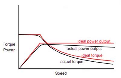

Cogging in stepper motors
Stepper motors also exhibit cogging torque, but in stepper motor discussions, it is often referred to as “detent torque.” Like cogging torque, detent torque is a result of magnetic equilibrium in a non-energized motor. This magnetic equilibrium must be overcome before the motor will rotate, which means that the detent torque reduces the amount of running torque the motor can produce. The amount of detent torque a stepper motor experiences is proportional to the motor’s speed, so the effect of detent torque on running torque is more substantial at higher motor speeds.
Permanent magnet and hybrid stepper motors, which use a permanent magnet rotor, exhibit detent torque; but variable reluctance steppers, which use a non-magnetized, soft iron rotor, do not. Of permanent magnet and hybrid types, hybrid steppers have higher detent torque due to their toothed rotors, which allows them to better manage the magnetic flux between the stator and the rotor.
Detent Torque
Detent torque reduces the ideal torque (and power) that the motor could produce, with the effect becoming larger as speed increases.
Image credit: Geckodrive Motor Controls
Detent torque is typically 5 to 20 percent of the motor’s holding torque, which is the amount of torque the motor can produce when the windings are energized but the rotor is stationary. But detent torque is not always a liability: When the motor is decelerating, it counters the motor’s momentum and helps it to stop more quickly.
