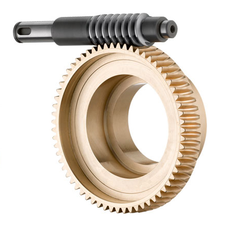

worm gear lubrication
In a worm gear assembly, the worm is typically made of steel and the gear is made of bronze.

Most gear types, such as helical, bevel and spur, experience both sliding and rolling contact as the teeth engage and mesh. But worm gears operate with mostly sliding contact between the worm and the gear (also referred to as the “worm wheel”). This predominantly sliding contact results in significant friction and very high operating temperatures. It also makes the formation of a hydrodynamic lubrication wedge, or film, difficult, so the gears operate predominantly under boundary lubrication conditions. A result of these combined operating factors is that worm gears require lubricants that can operate under significant heat and pressure, in addition to providing excellent lubricating properties.
Lubricants with extreme pressure (EP) additives seem to fit the bill, but there’s a catch: EP additives often contain activated sulfur or chlorine, both of which can damage yellow metals through softening or etching. (Most worm gears are made of a steel worm and a bronze gear.) To reduce these harmful effects, some EP lubricants now use deactivated sulfur.
