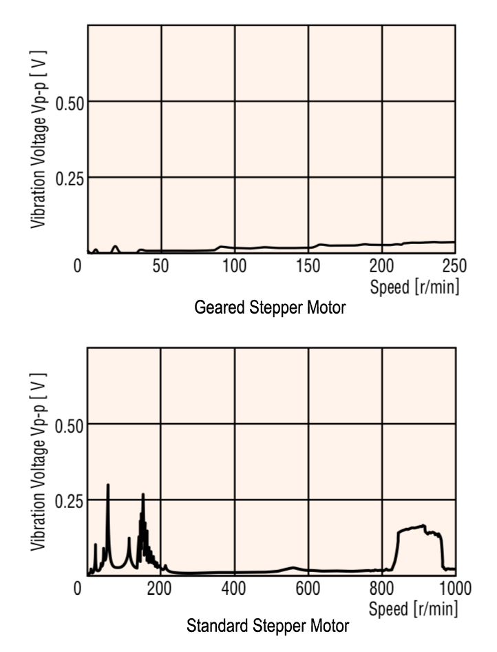

Reduce resonance and vibration
But speeding up the motor does have a benefit. The additional speed required by the motor when a gearbox is installed means the motor operates outside its resonant frequency range, where oscillations and vibrations can cause the motor to lose steps or even stall.
gearbox with stepper motor
The stepper motor with a gearbox (top) shows significantly less vibration than the non-geared stepper motor (bottom), especially at low speeds in the resonant frequency range.
Image credit: Oriental Motor USA Corp.

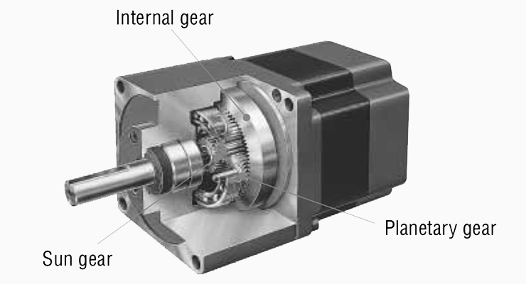

In addition to ensuring the gearbox has the correct torque, speed, and inertia values, it’s important to choose a high-precision, low-backlash gearbox — especially when connecting the gearbox to a stepper motor.
Recall that stepper motors operate in an open-loop system, and backlash in the gearbox degrades the system’s positioning accuracy, with no feedback to monitor or correct for positioning errors. This is why stepper applications often use high-precision planetary gearboxes, with backlash as low as 2 to 3 arcminutes. And some manufacturers offer stepper motors with harmonic gears that can exhibit zero backlash under most application conditions.
