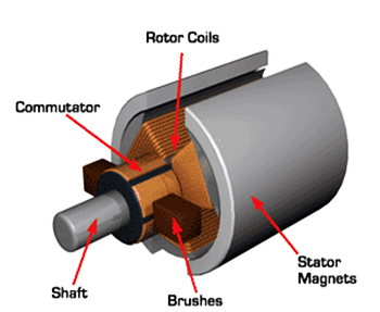

Brushed DC motors are also referred to as permanent magnet DC (PMDC) motors, because the stator incorporates permanent magnets on its inner diameter. The rotor (also referred to as the armature) consists of a slotted iron core with windings that are attached to a commutator. PMDC motors are mechanically commutated, with brushes that carry current to the windings. This is in contrast to brushless DC (BLDC) motors—a type commonly used in servo applications—which are commutated by electronic means rather than by a commutator and brushes.
brushed servo motors
Construction of a brushed DC motor.
