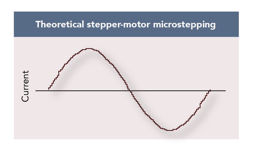

More specifically, a stepper motor’s torque depends on pole count (as explained in FAQ: What is pole count and why does it matter?) Usually a higher number of poles allows for greater torque. One or two phases on provides the most torque at certain rotations, because two sets of magnets engage simultaneously. That said, microstepping diminishes maximum torque because the steps come from stepping originating from drive shaping of current (and not motor pole count).
The fine steps and sinusoidal shape of a hypothetical microstepping curve are far from reality. Microstepping makes for lower maximum torque output.
