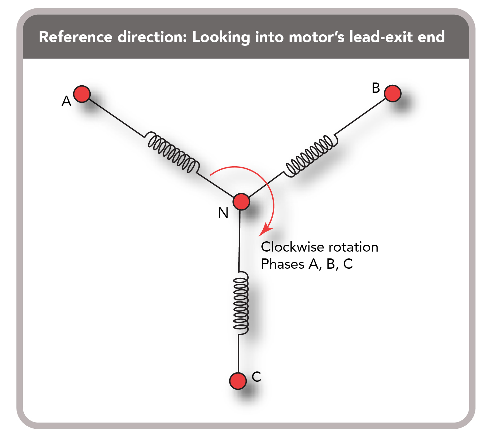

Phase A, B, C, clockwise (CW) rotation relative to a given direction of motor-rotor rotation — whether the reference is established by looking into the lead exit end of the motor or by its typical opposite end (the torque endbell) — does not matter as long as we are consistent. For the purposes of this article, we use phases A, B, and C for a clockwise (CW) rotation of the motor’s rotor as when viewed from the motor’s lead-exit end.
In this article, we use phases A, B, and C for a clockwise (CW) rotation as viewed from the lead-exit end of the motor.
Identifying a servo motor’s phases is straightforward with a dual-channel oscilloscope. The latter allows engineers to check the relative relationship of a motor’s phases (Bemf waveforms) with the defined rotor rotation. For complete instructions of how this can be accomplished, refer to this article’s section titled, Deep dive on using an oscilloscope to observe motor waveforms.
Then by investigating how the Bemf node voltages relate to each other (VAB, VBC, VCA, VAB, VBC, and so on) your motor’s phases will successfully identified and labeled A, B, C as the servo motor’s rotor is rotated in its manufacturer’s defined direction. For our example in this article, we assume this direction is CW when looking into the lead exit end or typical rear endbell of our housed servomotor.
On a related note, the node VAB or VAB should be read as the voltage at node A with respect to node B. Each node is labeled for future reference this way — with only one specifically identified letter. There is good reason for this.

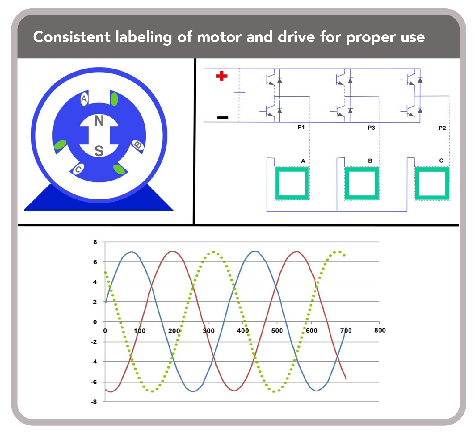

The other item that is absolutely critical to maintaining commutation harmony between products is the identified drive phase anchor (herein P1) for matching up with the motor’s phase anchor (phase A). Note that the drive phase P1 does not have to be the anchor. In reality, one would want to assign the drive’s anchor phase in harmony with the anchor phase of the motor for which commutation alignment is to be maintained.
One might assume we can correct the problem by switching motor phase connections A and B at the drive. However, this will mismatch the motor’s anchor phase A against the drive’s anchor phase P1 and produce a commutation phase angle offset of ±120° against all previously manufactured motor-drive product line combinations … which also means it doesn’t meet our original requirements.
Of course, switching motor phases A and B is a common practice in the electrical industry for changing direction of rotation of an AC induction motor. But this solution is undesirable because our goal is to have consistent and sequential drive connection labels A, B, and C … and not B, A, and C as they appear on the drive. Just relabeling connections B, A, and C to A, B, and C (or C, B, and A) maintains an undesirable commutation-phase-angle offset against all previously manufactured motor-drive product line combinations (unless corrected within the drive’s software and firmware or by the circuit layout).
So, what would be the best way to avoid or correct this initial fallacy?
First, let’s return to the common and conceivably logical case of the drive designer establishing the drive’s software, firmware, and physical circuitry such that a positive electrical rotation would present an output effectively placing a positive voltage at the drive’s initially labeled output phase P1 relative to P2 … then phase P2 relative to phase P3 … and then phase P3 relative to phase P1. Expected feedback for the positive electrical-source rotation would count up with anchor phase established as P1.
Assuming drive-to-motor connections are  P1 to motor phase A, P2 to B, and P3 to C,will yield a similar fallacy by suppling phase voltages with the Bemf relative to the desired defined direction rather that against the motor’s Bemf. So, what is the best way to correct and maintain the anchor phase of the drive P1 and the established motor anchor phase A?
The answer is that we flip the drive’s reference phase (so P2 connects to motor phase C) such that the drive’s supplied voltage is presented against the motor’s Bemf … and allowing the first phase (anchor P1) to be maintained per drives rule two listed above.  This means drive phase P3 connects to motor phase B … and P1 to motor phase A is maintained.
Our progression for a final topology would be something like that seen in the figure, Progression for a final topology.

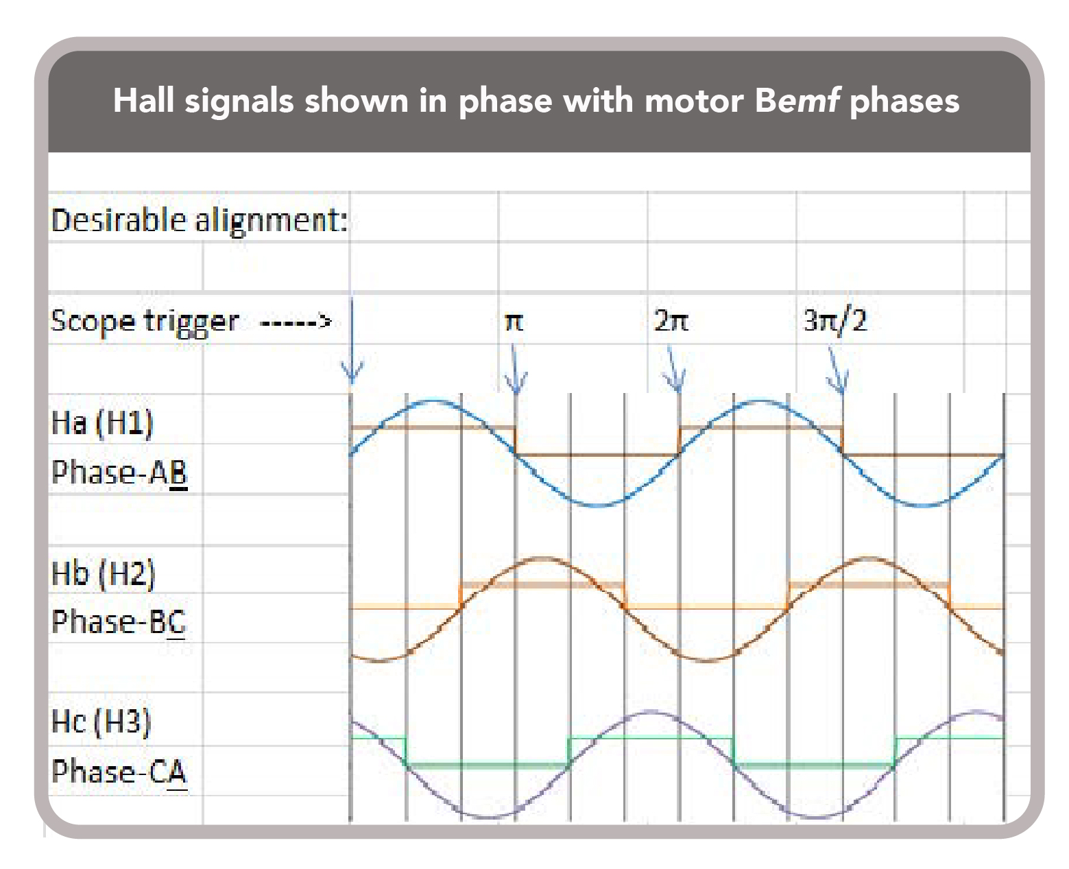

Also note that if Hall-effect devices (Halls) are being used, their drive association with their specific motor phase will also need to change depending on how the original firmware was written. If only the source reference for the anchor phase A is an issue, then redefining Hb (Hall-b) to be H_P3 and Hc to be H_P2 may complete the fix relative to drive P2 and P3. Review the Kollmorgen white paper titled, Servo Motor Phasing with Hall Commutation (pages T20-T22) at kollmorgen.com for more on this.
Hall-effect devices (sometimes just called Halls) often ] simplify six-step drive commutation for BLDC servomotors — or establish a drive’s commutation offset for a sine-wave-commutated AC PM servo motor.

To determine motor phase labels A, B, C while adhering to the ground rules outlined in this article’s first section (How can we confirm a manufacturer’s phase identification) we essentially will use the Bemf of the permanent magnet (PM) AC servo motor as an alternator. We will do this by connecting an oscilloscope to the motor, physically rotating the armature by hand, and monitoring the voltage waveforms generated relative to each other.
1. Label phase A of the motor per manufacturer’s documentation. This phase-A label is now your anchor or stake in the ground. Do not change or remove the phase A label.
2. Connect Channel 1 of the dual-channel oscilloscope to phase A.
3. Invert (INV) Channel 2 of the oscilloscope and connect either of the two remaining motor-phase wires to Channel 2.
4. Connect the ground clips of both oscilloscope probes to the remaining motor phase lead (terminal).
5. Set oscilloscope coupling (both channels) to DC and Channel 1 as the trigger for the capture of the oscilloscope traces with a positive going edge. A positive-going trigger just above zero should work just fine.
6. Start by setting the oscilloscope Channel 1 and 2 timebase to between 5 to 40 msec per division. Then set Channel 1 and 2 amplitudes between: 2 and 20 V per division. Then adjust as needed for Step 7 listed below.
7. Rotate the motor’s shaft in the CW direction. For the example we’ve used in this article, this is when looking into the lead-exit end of the motor — typically the rear endbell of a housed motor.
This means that if you are looking into the opposite end (the mounting end bell) of the motor, you will need to rotate the rotor shaft CCW to maintain harmony with our example. In fact, you’ll need to do this over and over (multiple times for the best scope rendering) while adjusting the oscilloscope volts/division and timebase.
8. After adjusting the oscilloscope’s timebase and voltage amplitude, you should get a scope plot that looks similar to that in the figure titled, Oscilloscope plot of motor hand-turned as generator (without the green dotted line). If available, using the oscilloscope’s capture-and-hold feature can be very helpful at this stage.
After adjusting the oscilloscope’s timebase and voltage amplitude, you should get a scope plot that looks similar to the one here.
9. If your present Bemf waveforms look like Channel 1 and 2 (blue leading red respective to the trigger in the figure titled, Oscilloscope plot of motor hand-turned as generator) label the wire going to Channel 2 as phase C, and the wire connected to the oscilloscope ground clips as Phase B. If your Channel 2 waveform looks like it is shifted to the right over the dotted green line shown in the figure, label the wire going to Channel 2 as phase B … and the wire connected to the oscilloscope ground clips as phase C.
