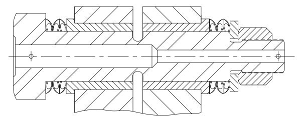

One drawback of shear pin torque limiters is that because the shear pin is sacrificed, it must be replaced, meaning downtime and labor costs are incurred before a restart is possible. Another drawback is the difficulty in predicting or setting the torque load at which the shear pin will break. The accuracy of a shear pin design’s rated torque, for example, is typically in the range of ±20 percent, while the rated torque accuracy of a ball detent torque limiter is in the range of ±5 percent. And even small stresses that occur during normal operation can weaken the shear pin over time and reduce the amount of torque required before the pin will break. To combat these issues, some manufacturers use specially-designed hollow shear pins.
hollow shear pin
A hollow shear pin can provide better protection against fatigue and better breaking torque accuracy.

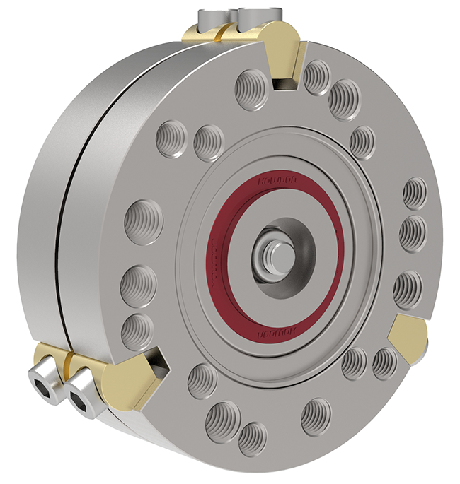

Another variation on the basic shear pin design uses wedge-shaped shear pins. (This design is branded as the “Wedgegard shear pin torque limiter” by the Howdon company.) Like traditional shear pin designs, the wedge pins are designed to break at a specific torque, but the accuracy of breaking torque is typically better than ±10 percent — a significant improvement over the accuracy of traditional shear pins. The wedgepins are also much easier to replace than traditional shear pins, reducing downtime and labor for resetting the torque limiter once it has tripped.
wedge pin torque limiter
Wedge-shaped pins, or wedgepins, are used in this torque limiter from Howdon. Wedgepins provide better breaking torque accuracy and easier replacement when the torque limiter is tripped.
