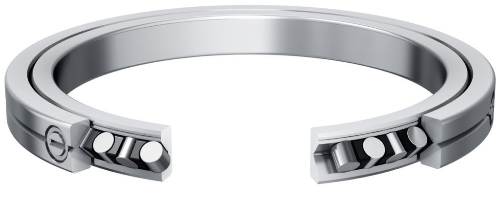

A crossed roller bearing is a type of rotary bearing that uses cylindrical rollers arranged in a crisscross pattern, with each roller oriented at a 90 degree angle relative to the one adjacent to it. This arrangement allows crossed roller bearings to withstand radial, axial, and moment loads, so they can often replace dual-bearing arrangements, for applications with limited installation space. And because the rollers form line contact with the raceways, crossed roller designs exhibit very high stiffness and minimal deflection under load. These characteristics make crossed roller bearings ideal for rotating motion components such as rotary actuators and rotary ball splines.

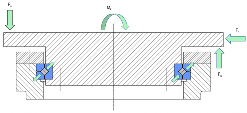

How to account for axial, moment, or combined loads
The basic dynamic load rating for a crossed roller bearing is for loads applied in the radial direction.
When a crossed roller bearing is subjected to axial and/or moment loads, the equivalent radial load must be calculated based on the combination of the applied radial, axial, and moment loads.
Crossed roller bearings can withstand radial, axial, and moment loading.
Image credit: IBO
crossed roller bearing life
Pr = dynamic equivalent radial load (N)
X = radial load coefficient
Fr = applied radial load (N)
M = applied moment load (Nm)
Dp = pitch circle diameter of rollers (m)
Y = axial load coefficient
Fa = applied axial load (N)
Radial and axial load coefficients
The radial and axial load coefficients (X and Y, respectively) are commonly used for rotary bearings to account for how the loads are distributed within the bearing. Their values change based on the ratio of the axial and radial loads.
For the case of crossed roller bearings, the threshold for the axial-to-radial load ratio is 1.5, at which point the axial load begins to affect how the rollers ride within the raceways, and therefore, how the load is distributed across each roller.
For an axial-to-radial load ratio equal to or less than 1.5, the radial load coefficient is higher than the axial load coefficient (1.0 versus 0.45), meaning the radial load plays a more significant role in bearing fatigue.
If
Then
However, if the axial-to-radial load ratio exceeds 1.5, the radial and axial loads are multiplied by the same load coefficient (0.67), meaning they play an equal role in causing bearing fatigue.
If
Then
Life based on equivalent radial load
