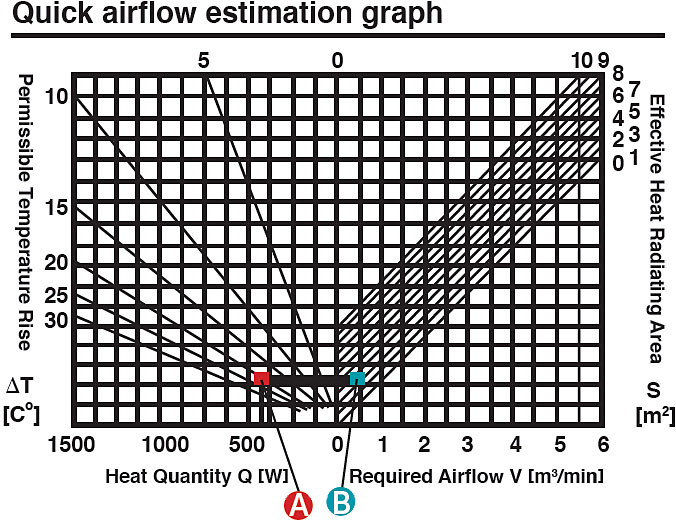

Selecting the optimum cooling performance involves choosing the fan airflow under the desired environmental conditions. Selecting the correct axial fan involves a number of calculations. The required airflow calculations use a graph designated as the Quick Air Flow Estimation Graph. This figure is a composite of two separate charts properly aligned vertically to provide a viable solution.
This process begins with the equation listed below:
V = 1/20 x {(Q/ΔT-U) x S} x SF
where:
Q = heat factor in watts
ΔT = selected temperature rise in degrees C
U = heat transfer co-efficient in watts/(sq meter x Kelvin)
S = effective heat radiating area in square meters
SF = safety factor
V = computed air flow in cubic meters per minute
The calculation process begins below:
First, select Q = 450 W and ΔT as 20° C temperature. Locate the intersection of these two elements located on the Quick Air Flow Estimation graph and label this intersection as point A. Next, draw a horizontal line to the right intersecting the family of skewed lines at the correct value of the effective Heat Radiating Area or cross section. The intersection of these two performance parameters is labeled as point B.
quick-airflow-estimation-graph
Then construct a vertical line downward from point B to intersect the X axis. The X-axis value on the right side indicates the airflow value which is 0.5 m3/min. Multiply this value by a safety factor of 2 to achieve the final answer of 1.0 m3/min or 35.3 ft3/min.
