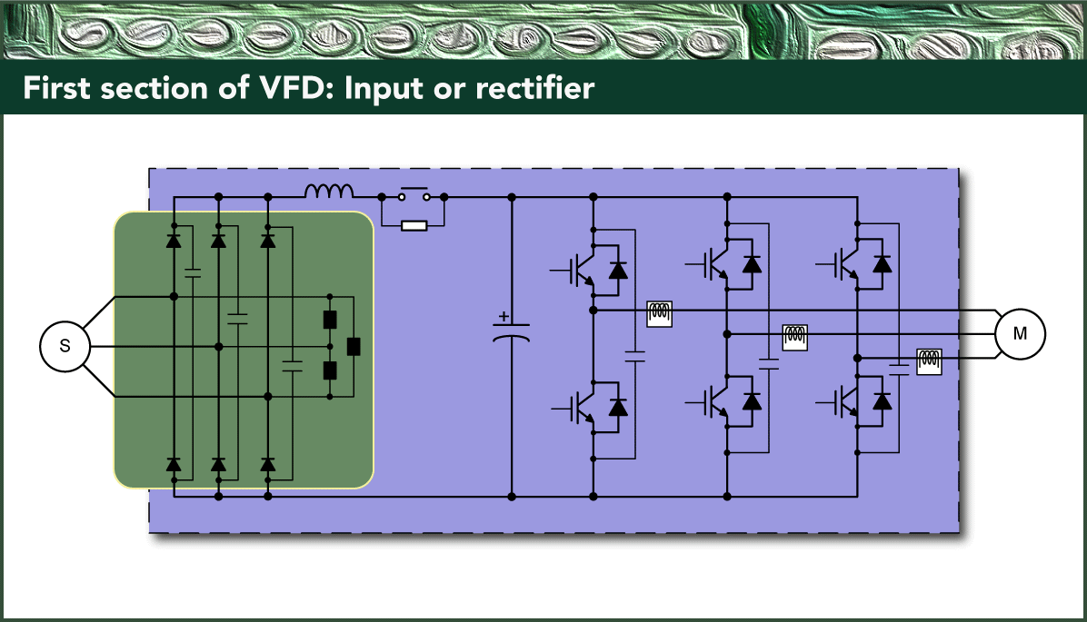

VFD input check (at the rectifier)
In today’s VFDs, the input or rectifier section is comprised of input diodes that convert an incoming three-phase ac sine wave into a rectified dc supply. There are at least two diodes for each phase. They are positioned in opposite conducting orientation to allow full-wave rectification. To check the input section, we need to perform simple diode checks. These checks include testing the forward and reverse bias direction of both diodes in each phase. This process uses the input terminals R/L1, S/L2, T/L3 on the drive and the dc bus terminals.
If you are unsure about where the input terminals are, refer to the VFD’s manual.
With a multimeter set to diode check …
… put the +(Red) lead on the input terminal (R/L1) and the –(Black) lead on the (+) DC bus terminal. This isolates the positive R/L1 phased diode. A good diode should read around 0.5 Vdc in the forward-bias direction. Repeat this process for the S/L2 and T/L3 terminals while leaving the –(Black) lead on the (+) dc bus terminal.
VFD input rectifier
The first section of a VFD is the input rectifier section, which includes input diodes that chop three-phase ac waves into a positive and negative dc supply.
Note: When making this measurement, look for consistency across the all three input terminals. The measurement of 0.5 Vdc is only an approximation and can change depending on the VFD and model size. If at any time the meter reads 0 V, then that diode is shorted.
The next step is to check the reverse bias direction of the diodes. Move the –(Black) multimeter lead to the R/L1 terminal, and move the +(Red) multimeter lead to the (+) dc bus terminal. Then check the remaining two inputs by moving the –(Black) multimeter lead to the S/L2 and T/L3 terminals. The multimeter should eventually display (OL) after charging the drive’s filter capacitors. OL occurs when the power supply in the meter is unable to force current through the diode in the set direction.
We are now done with the upper diodes and need to check both directions of the remaining diodes on the rectifier. We start by placing the +(Red) multimeter lead on the (-) bus terminal and the –(Black) multimeter lead on the R/L1 terminal. This again should read around 0.5 Vdc. From there, move the –(Black) multimeter lead to the remaining S/L2 and T/L3 terminals while looking for consistency between the three measurements. Some engineers consider a variance of more than 0.05 Vdc between them to be a bad sign, as this could mean that one or more diodes need replacement.
Finally, move the -(Black) multimeter lead to the (-) dc bus terminal and the +(Red) lead to the R/L1 input terminal, then check the S/L2 and T/L3 input terminals, again making sure that the meter reads OL after a short time charging the filter capacitors. When charging the filter capacitors, the time can vary and increases with drive size.
We have now checked all the diodes in both bias directions. If at any time the meter reads 0 V, then that diode is shorted.

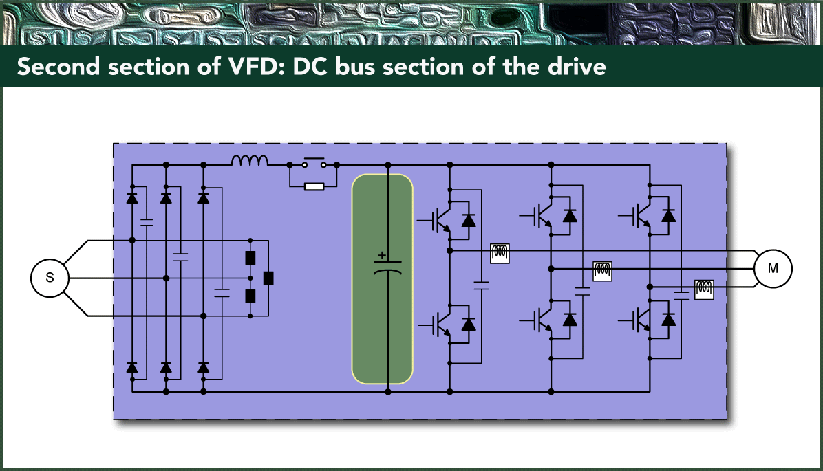

DC bus check on VFDs
After the diodes rectify the incoming ac wave into dc, the dc bus or dc capacitors store the voltage and have a smoothing effect on the dc bus voltage ripple. To fully check the capacitors, an engineer or plant worker would need to pull the individual capacitors out of the system and use a tester supporting high-microfarad capacitors.
VFD dc bus section
In lieu of this (for no-power checks) visual inspection for any signs of physical damage or electrolytic fluid leaking from the capacitor is sufficient. Sometimes it’s even possible to smell if the capacitor isn’t good anymore … and the smell will most likely be a strong scent. If the unit in question has a lot of hours on it and maintenance personnel are already replacing other components, it’s not a bad idea to go ahead and replace the dc bus capacitors.

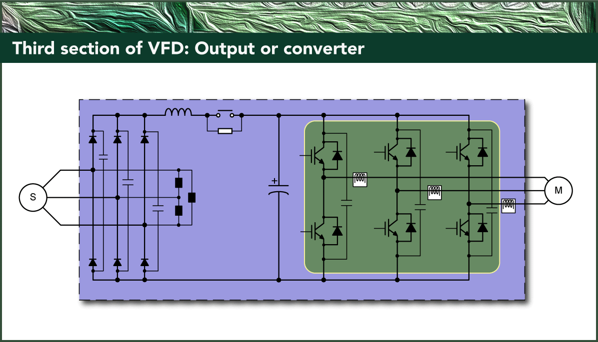

VFD output check (at the inverter)
The third and final section is the output or inverter section. This usually consists of insulated gate bipolar transistors (IGBTs). The IGBTs take stored dc from the bus capacitors and work together to form a simulated ac output wave to the motor. The VFD uses pulse-width modulation (PWM) to control the voltage and frequency applied to the motor. The IGBT includes an emitter, collector, gate and free-wheeling diode. The VFD modulates the pulses applied to the motor by varying how long it applies a voltage between the gate-emitter junctions of the IGBT. This is called gating and it happens thousands of times per second.
VFD output or converter
The final VFD section is the output or converter. The free-wheeling diodes here get checked just as those at the drive input do.
The gating signals themselves can’t be checked without power and are usually checked once power is applied, and the drive is running with no load — in other words, with no motor. That check involves using an oscilloscope to ensure the IGBTs are gating properly.
The free-wheeling diode completes the output circuit and handles any regeneration from the motor going back into the drive. This regenerated energy is then introduced back into the dc bus capacitors.
Our last check is basically another set of diode checks. Fortunately, in most cases the IGBT fails because the free-wheeling diode has shorted. How do we check this? We check it the same way we did the VFD’s input. More specifically, check the free-wheeling diodes just as the rectifier’s diodes were checked … but this time, use the U/T1, V/T2, and W/T3 terminals instead of the R/L1, S/L2, and T/L3 terminals. If the measurements show a good diode, you’re done. If the measurements show a short circuit (less than 0.5 Vdc in both directions) then you have a shorted IGBT.
